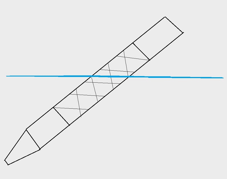

If you put the dipstick in perpendicular to the oil you will magically notice why the hashmarks are at an angle on the stick! It sounds like you're putting it in parallel to the oil. You need to rotate 90 degrees.
Made this crude drawing for you to illustrate what I mean. In my example the oil is at 3.5 out of the 5 hash marks. 8)
I hope this makes sense on paper. :lol:

E. Foster Salsbury wrote:If you put the dipstick in perpendicular to the oil you will magically notice why the hashmarks are at an angle on the stick! It sounds like you're putting it in parallel to the oil. You need to rotate 90 degrees.
Nice going, good example.

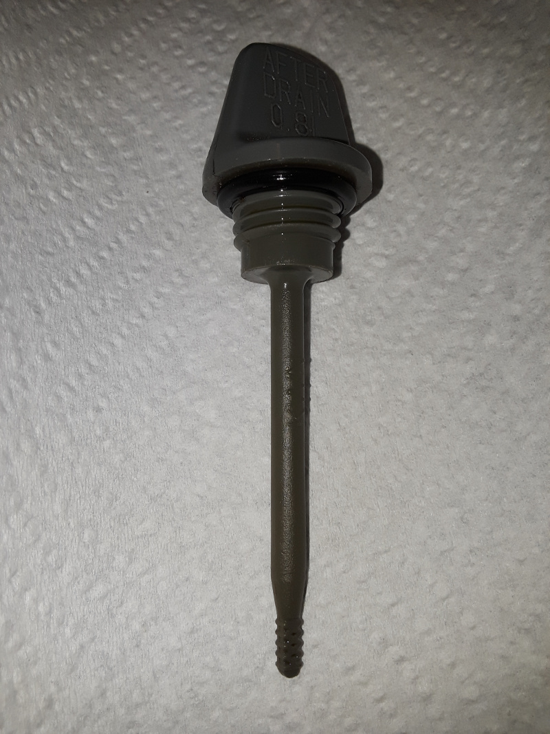

I have a PCX and still am not sure where the oil level should be. On a pcx the hash marks are at the bottom of the stick. I have been keeping the oil within the hash Mark's, but there is a lot of stick and just a tiny amount of hash marks. Where should the oil appear on this stick?
Re: Dipstick shows low oil on one side, but fine on the othe
When I had my PCX it was tough sometimes to see where the oil level was against the dark plastic. I'd look for "shine" in sun from oil residue. When the oil is new and really clean it's hard to tell. As it gets more miles on it and darker it may be easier to read but usually by then it should have already been changed if it's really gunky.
Also, after wiping the oil stick dry, I'd reinsert the oil stick into the crankcase (did not screw it in), remove it, and I'd carefully run my index finger along the top edge of the oil level mark and work my way down until I noticed oil on my finger. That way I had both a visual and physical reference. It's important to try and avoid hitting the sides of the oil filler neck which could leave a false indication. Just my two cents worth. ;)
Mel46 wrote:I have a PCX and still am not sure where the oil level should be. On a pcx the hash marks are at the bottom of the stick. I have been keeping the oil within the hash Mark's, but there is a lot of stick and just a tiny amount of hash marks. Where should the oil appear on this stick?
On the hash marks but not over.
