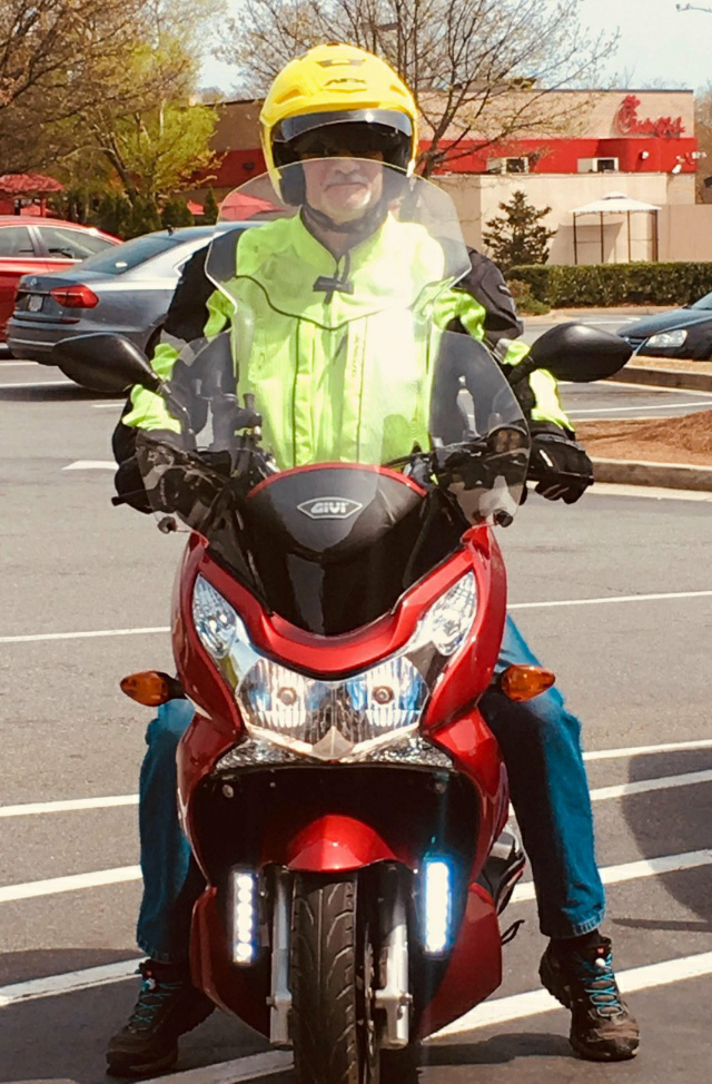

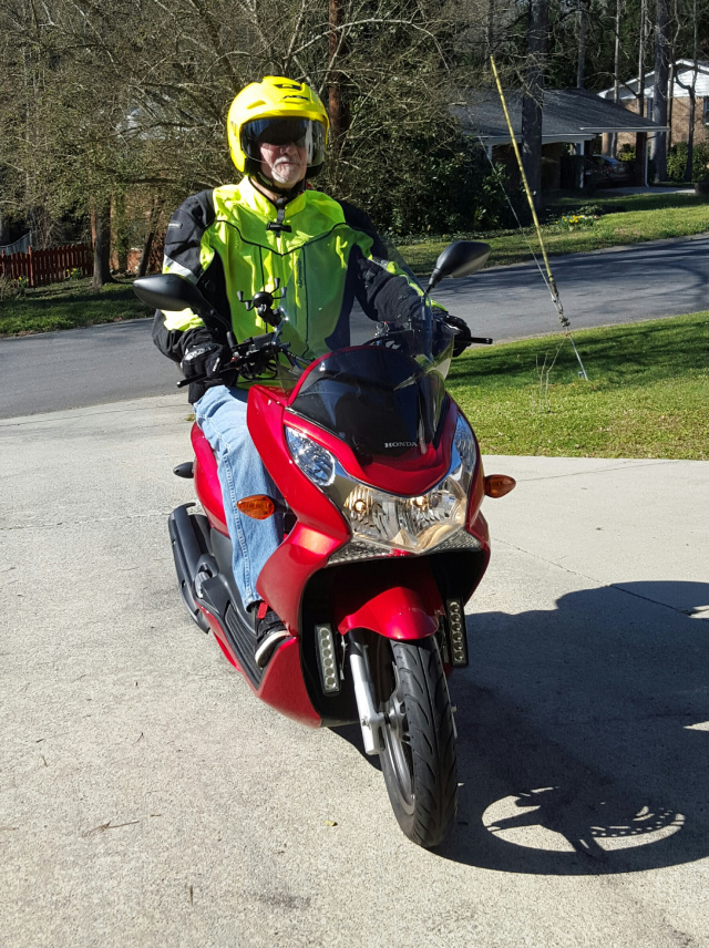

Re: Favorite windshield?
Here are pictures for size comparisons on the GIVI windscreens. The mid high is tinted so you should have no problem seeing how high it is on the bike.
PCX with mid GIVI windscreen.jpg (339.81 KiB) Viewed 9361 times
PCX with tall GIVI windscreen.jpg (303.39 KiB) Viewed 9361 times
Mel46 wrote:Here are pictures for size comparisons on the GIVI windscreens. The mid high is tinted so you should have no problem seeing how high it is on the bike.
Why do you wear fluorescents and ride with LEDs so everyone can see you better? Then ride with a tinted visor so you can see everyone else worse.
