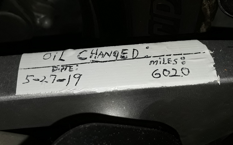

Speaking of oil, I just now finished changing the oil on my PCX. I dont have a stand to put the bike on when changing the oil or doing maintenance, but it had to be done, soooo...
When I change the oil on my bikes I note it on some white duct tape I put on the swingarm. As long as you clean the arm to remove all grease, it sticks quite well.
oil change label.jpg (111.68 KiB) Viewed 7426 times

[quote="Mel46"]Speaking of oil, I just now finished changing the oil on my PCX. I dont have a stand to put the bike on when changing the oil or doing maintenance, but it had to be done, soooo...
[/quotei]
I write the same on final blank pages of owner's manual, kept under the seat.
