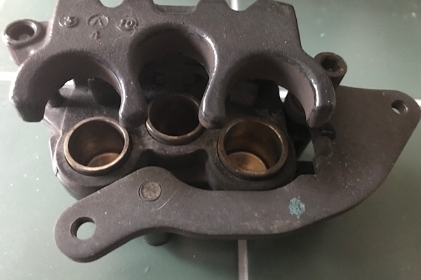

I thought the caliber has only two pistons. What do you mean by "hanging up"? What does relieving the issue mean? Back to normal front brake operation? Then why not use the rear brakes?honkerman wrote: Turns out the center piston on the front caliper was hanging up. If I snapped the left brake lever, it seemed to relieve the issue, so I just relied on the outer two pistons for the rest of the ride home...And had no back brakes for over 100 miles.

If you have Combined brake, the front caliper has three pistons. The center of the three is for the combined brakes. I could feel the left brake lever go firm on me and the front wheel would wobble a bit. If I snapped the lever on and off, it would go back to normal.Inoplanetyanin wrote:I thought the caliber has only two pistons. What do you mean by "hanging up"? What does relieving the issue mean? Back to normal front brake operation? Then why not use the rear brakes?honkerman wrote: Turns out the center piston on the front caliper was hanging up. If I snapped the left brake lever, it seemed to relieve the issue, so I just relied on the outer two pistons for the rest of the ride home...And had no back brakes for over 100 miles.
- Three piston caliper

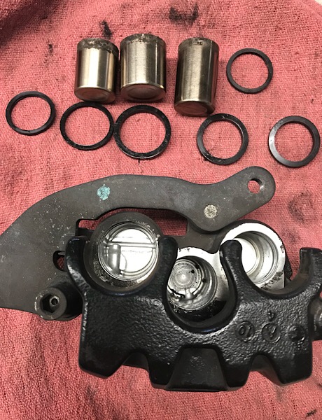

In case anyone is interested, here is what the cbs caliper looks like disassembled.
