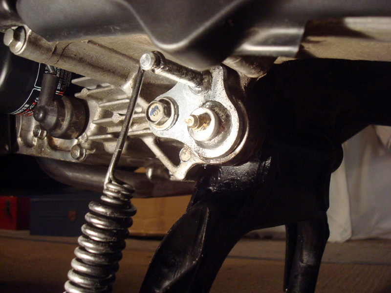

The stand can soon seize up if not lubricated, say, every year, but a bit of a pain to remove. However, as the pivot shaft is hollow I was able to modify it to accept a grease nipple so lubrication is now really easy.
I took the shaft out, (using the washer trick on the spring), and then made an aluminium plug press fitted into each end of the shaft. One end plain and the other threaded to accept a grease nipple. The plain end was cross drilled to allow the split pin to be refitted. A small hole was drilled through the tube to allow grease to flow through the shaft and up into the stand pivot points. All assembled and it works a treat.
