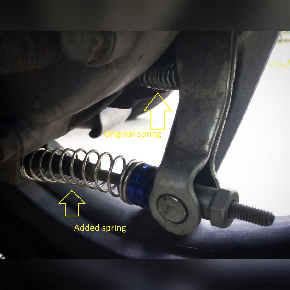

Problem solved.
Lube the cam and just added another spring on the brake arm and the overall feel of the brake lever improved a great deal. It gave the brake a consistent feel compared to the on and off sticking feel of the stock spring.
Those who want a more consistent feel on the rear brake can try this too.
