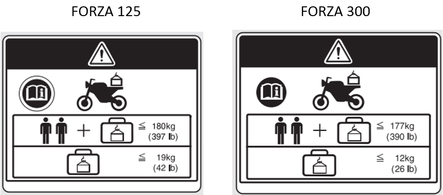

I came across an interesting information. Comparing Forza 125 to Forza 300 I found out that 300 has a lower maximum load. That leads me to conclusion that 125 and 300 use exactly the same chassis and the higher engine weight of 300 simply reduces the max load.

Yes the current model 125 and 300 are identical other than engine parts.

In addition, there appear to be a few minor differences in length, width and height and also wheelbase.

Oldie wrote:In addition, there appear to be a few minor differences in length, width and height and also wheelbase.
Yes, I've noticed that.
But the bottom line is: Forza 300 = 20km/h faster top speed, less max load, higher consumption, no idling/stop... I guess I'll stick with my darling Forza 125.
I think the length width height discrepancies are errors on the spec sheet.
When you look at them in the showroom, they appear identical.
The longer wheelbase on the 300 will be down to the larger engine.
