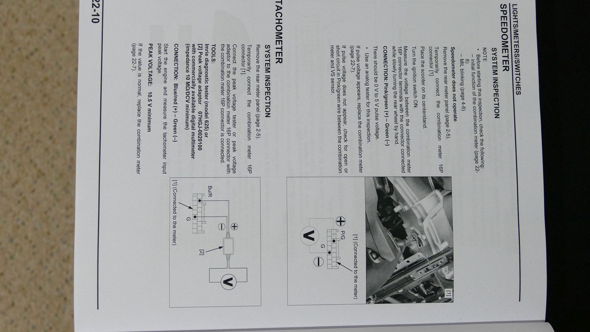

I'm having trouble to know which is the power of the speedometer/odometer, may i ask that is there anyway to know ? ...i don't have the wiring i have to do the wiring manually.........

Forza 125D/ADf 2015
