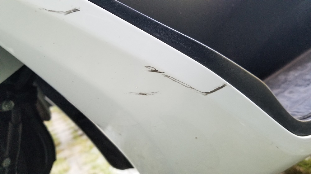

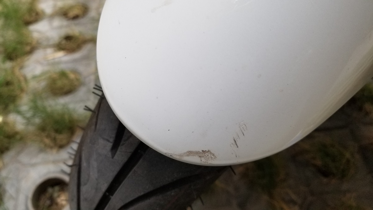

Pics...
- 20190203_095708.jpg (124.36 KiB) Viewed 6271 times
- 20190203_095658.jpg (151.31 KiB) Viewed 6271 times

Most of those dings look to be through the clearcoat and the paint - down to the base plastic. Painting, then fairing with finer and finer abrasives seems the only repair. Finding the right color of paint will be very tricky, but maybe you know an artist with a good eye (and a nice collection of acrylic paints). You might also find a close match with nail polish - you never know until you look.
Good luck, and I hope to see the fruits of your labor (or the story of your trials and tribulations) sometime down the road.

Buy the panel.It will be cheaper and look better in the long run.The whole panel needs to be refinished and repainted.Materials and labor will exceed the cost of a new panel.

Have you tried Goo Gone? From what I see most of the marks look removable. Try easy things first, to see if those are just rub marks. Put the Goo Gone on a cloth and rub each mark. You may have to do this a few times to get each mark off.
I have also used Novus (1,2, and 3). They work well too.

Great! thank you for the pics! See better, Blow them up folks.
Start simple.
I would definitely try removing the bulk of that mess first > The black "looking" scuff marks. I believe you can make these panels look 80% better just by doing that, and the paint that's missing will then appear minimized. Maybe??
"Step by Step..." take it slow. Patience brings surprises
What about WD40 peeps? Medium to light rubs of that? > followed by immediate rinsing?
I used it on my truck's side door after a wheelchair ran into it (huh? Yeah). It planted a nice size black rubber scuff mark. Took it right off.
Should be okay to use on our scoot plastics right?
