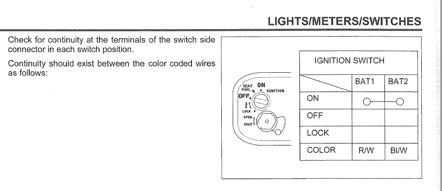

Hi Neil, I have not done this yet, my PCX is a week old. It looks easier to get power right from the ignition. This way your wires will be short.
