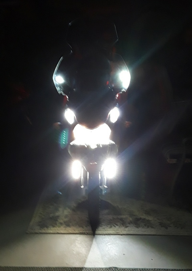

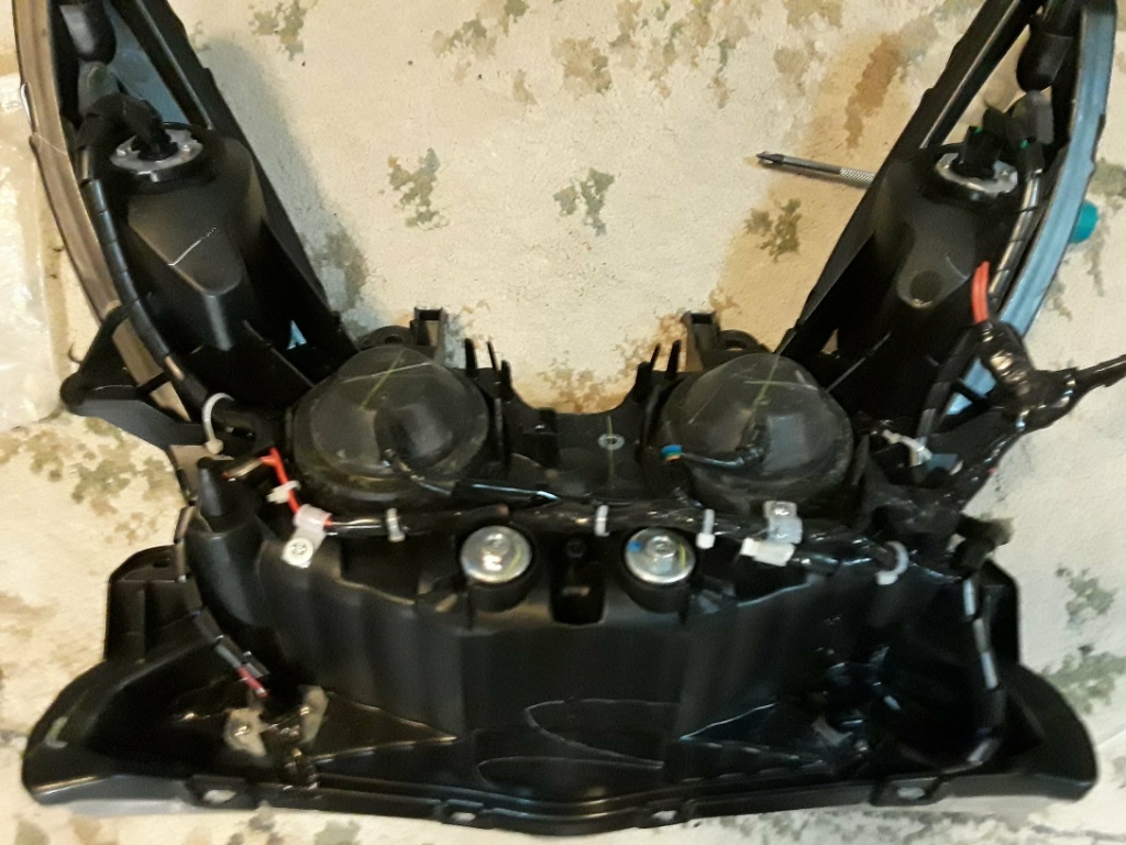

By the way, if you like a project, the 2013 model only has the two main headlights. The rest of the slots are not even open for bulb installation.
Keeping that in mind, I took on the task of rewiring and adding LED lights to my headlight assembly, though I kept the HS5 bulbs in the main headlight slots. (They don't come with HS5 bulbs in those slots originally, but with effort you can change them out...what a pain that was! It is much easier to just take the bike apart during winter storage and upgrade everything then.)
Now:
Front lights now.jpg (104.07 KiB) Viewed 6581 times
I have recently removed the very top lights in order to add hazard lights.
