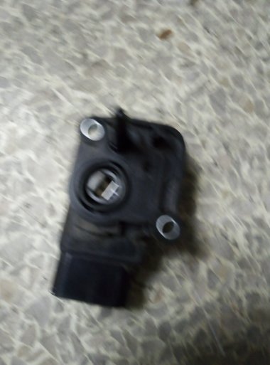

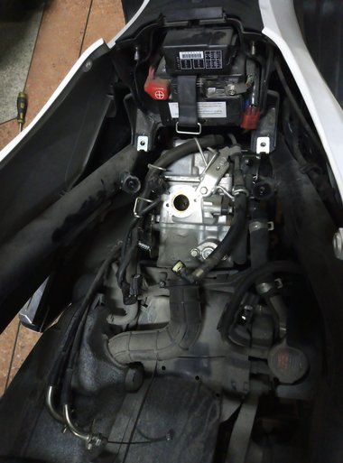

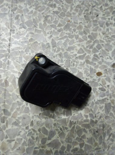

Late update
Done changing the TPS, and it solved the problem immediately.
photos of the TPS
cost: $45 for new TPS including labor

Re: TPS problem
Wow is right! TPS
Always amazes me that something like this, inexpensive, small, made of plastic can cause this problem.
Glad they pinpointed it right away, that's a blessing in itself! Part was cheap, installed and off you go (as if it never happened).
Cheers Alx and I thank you for the info and pics of this unbeknownst part 8) (to me anyway).
