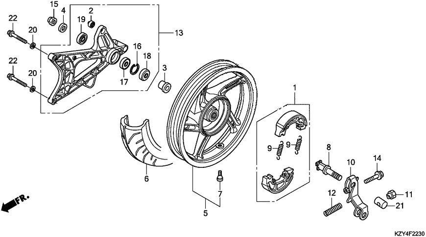

Here's a diagram of the rear wheel parts and their orientations. I recently removed my rear wheel and there's really not a whole lot that can bugger up the re-installation other than getting the spacers out of order or in the wrong orientation (for example, part #3 could be turned around on the axle). You can pull the wheel off yourself and check that all of the spacers are correct. You have to remove the muffler first, and an impact wrench makes it easy to remove the big 22mm axle locknut. Here's one video showing how to do it, but look for other videos too.
