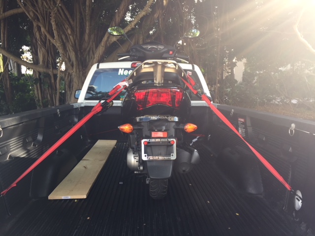

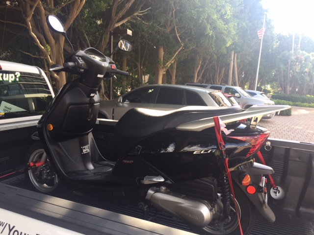

That should work fine. I watched the vid below before moving my Elite recently - it’s pretty good and talks about attaching the rear around the 7 minute mark including using rear pegs to do so. Here’s some pics of my Elite strapped down using the rear rack / grab handles - I just double checked the tightness of the straps a couple times when I started to get going and it went fine. Good luck!Oldie wrote:Thinking that I'll make use of the pillion footpegs.
