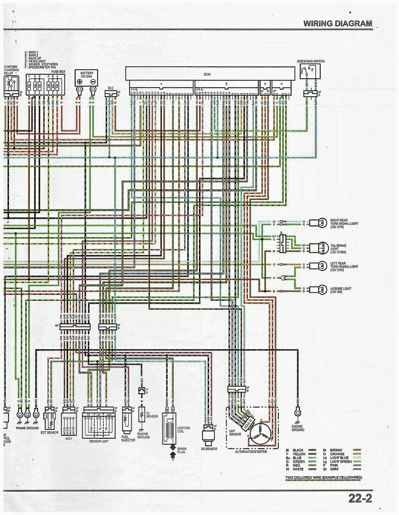

Re: Headlights are noticeably flickering at IDLE..
I have looked at my wiring diagram and I don't see a diode represented in it anywhere, and yet I k ow for certain that it uses them. That makes me wonder if they are built into the starter. If that is the case then you have two choices. Either replace the starter or have someone try to take it apart and see if they can locate the diodes.
High Contrast back.jpg (364.23 KiB) Viewed 3319 times
Here is part of the wiring diagram. It has the starter/alternator. Maybe someone on this thread can find the diodes. I can't.
DushFernando92
Posts: 47
Joined: Sun Apr 29, 2018 8:48 pm
Location: Sri Lanka
Post by DushFernando92 »
Mel46 wrote:
If you can't, then there is no way I would find them. I don't have 10% of your experience with these things.. Thankfully, I'll check the grounds with this diagrams.. Appreciate it..

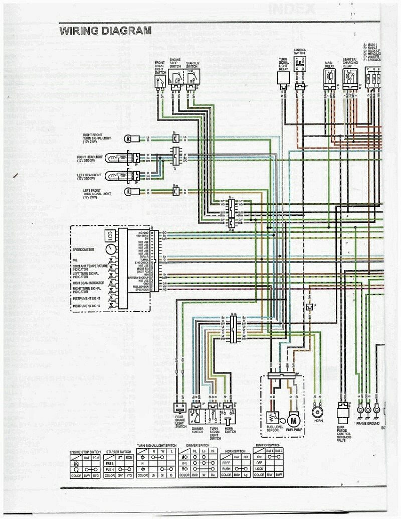

I can attach the other half of the diagram once I get home. We are out and about right now, so I am sending this from my phone.
Here is the other half of the wiring diagram.
