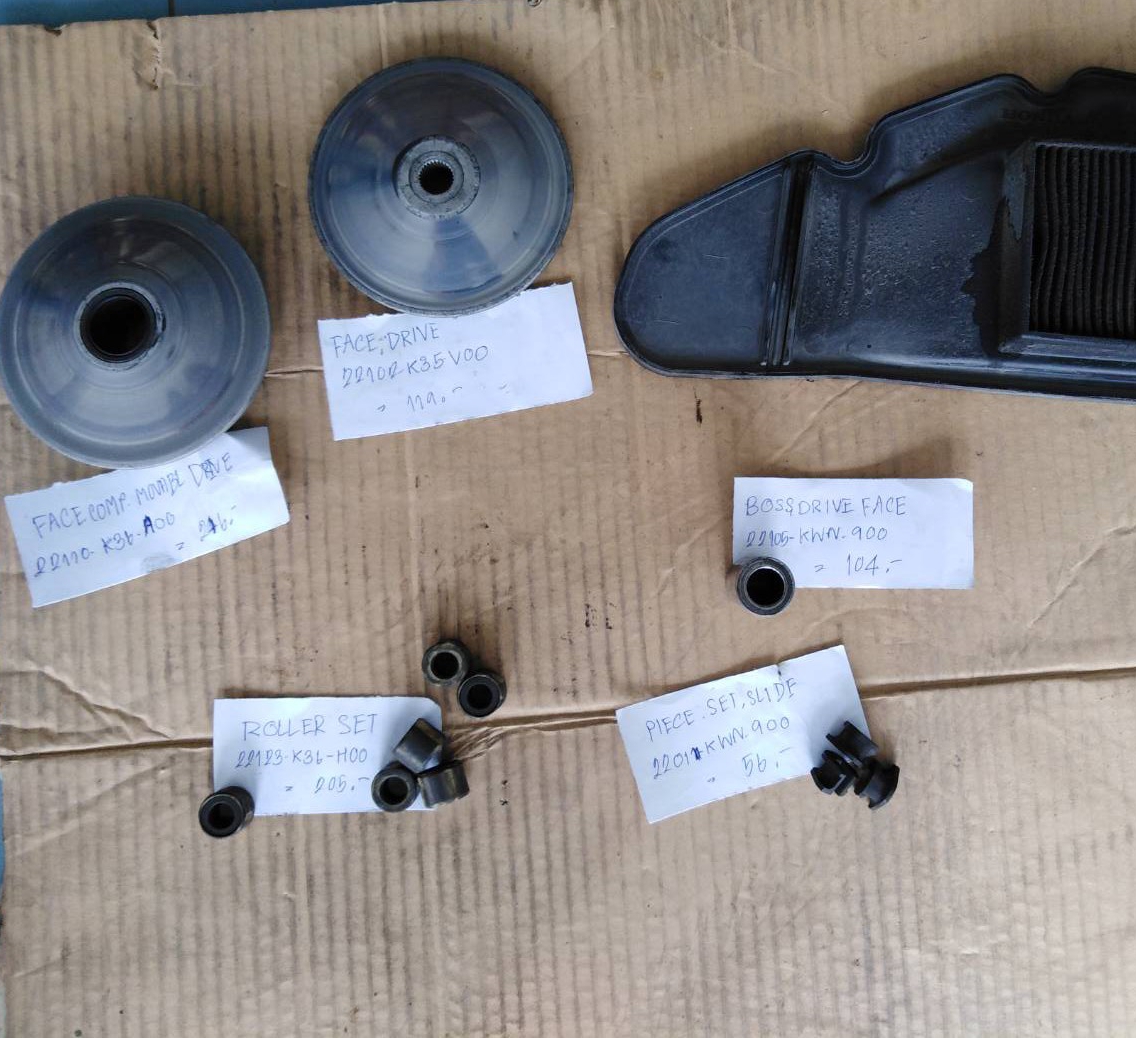

Maximum speed reduction was coz of this parts
- 20181022_180309.jpg (660.36 KiB) Viewed 7171 times
Re: Honda PCX engine lost power and maximum speed reduction
Looks like you have been riding a LOT! Those parts are worn out, not just worn some. .
... and look at that air filter!

To think that he is servicing it regularly, I wonder why the worn rollers and plates haven't been changed earlier. And that air filter oh my, did you ride in the flood?
Go for all the proposed repairs, quoted prices are not that bad..

Yeah, that's filter after flooding that's why I asked change 1000 km before.
About rollers nobody didn't tell me in motorcycle shop change it before. It affected only on maximum speed not too much critical for riding.
Yeah I asked them change all parts from list
