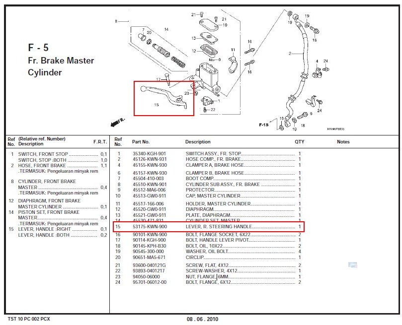

I can't seem to find the right brake lever on any of the parts schematics. Does anybody know the part number for it?
My PCX got blown over and the brake lever got bent. It's a 2013 PCX 150.

I don't have a parts list for the PCX150, but probability is high, that Part No.The_Head wrote:I can't seem to find the right brake lever on any of the parts schematics. Does anybody know the part number for it?
Thanks in advance!
53175-KWN-900 LEVER, R. STEERING HANDLE
will fit. The number is from the PCX125 parts list. At least it is worth a look...
- Extract from parts list
- x1.jpg (97.58 KiB) Viewed 2018 times

Re: Need help finding a part
This link shows the part #13 53175-KWN-305 LEVER, R. HANDLEBAR (COO): http://www.goldenmotorsports.com/pages/ ... KZY4F0500A
It looks like the right one.

I think it's worth noting that any PCX lever for any year or model (125 or 150) is interchangable.
