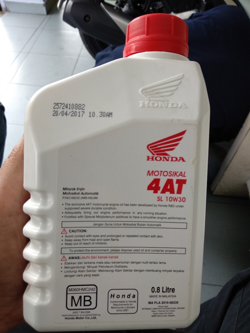

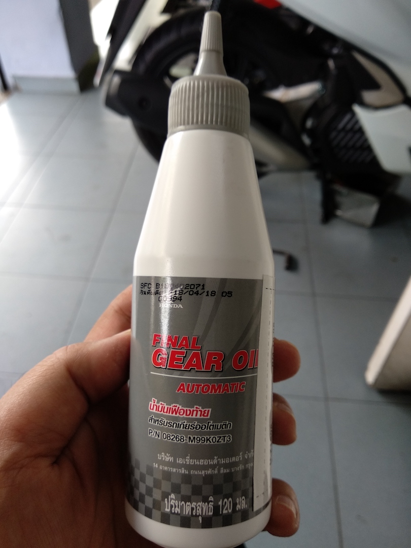

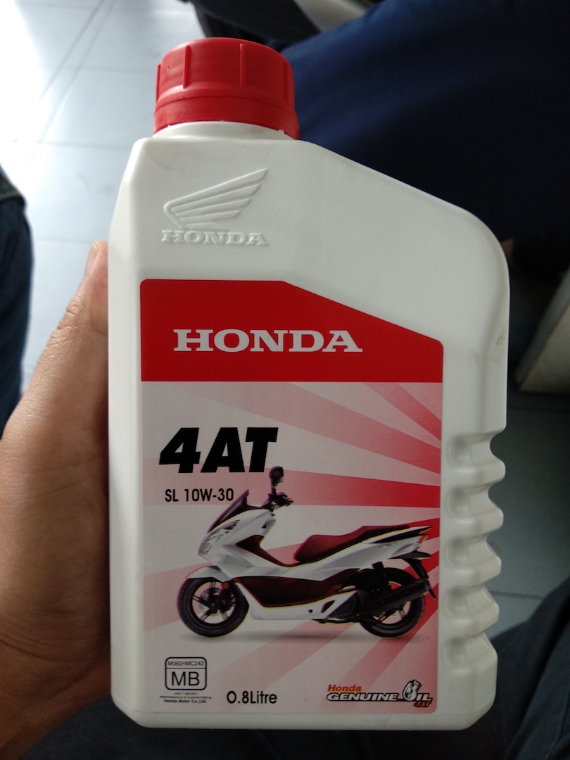

Hi
I am from Malaysia and bought my brand new PCX more than a month ago.
The PCX was called in for her first service by the authorised dealer after a month though it has only done 426 km. Supposedly, PCX would undergo first service after 1,000 km. I went anyway because many PCX users said the first service should be carried out after 1 month.
I went with Honda Malaysia engine oil for the PCX, which was manufactured by Petronas. Many said it is of mineral type and can last up to 2,000 km. I went with it because it is made for Honda Malaysia by Petronas, and because it is cheap. RM25 is about GBP6.
The dealer told me that the CVT oil needed to be replaced and I went for Thailand's Honda final gear oil which costed me RM10 or about GBP1.80.
Labour is free for this service.
Before the service, my PCX was averaging 47.3km/l, and I think my average speed was 75km/h. Will monitor the fuel consumption after the service.
Here are some photos.

- Honda CVT oil RM10
- Honda final gear oil.jpg (295.64 KiB) Viewed 7095 times
- Honda engine oil descriptions (rear of the bottle)
- Honda 4AT rear.jpg (315.85 KiB) Viewed 7095 times
- Honda Engine oil RM25
- Honda 4AT front.jpg (300.98 KiB) Viewed 7095 times
