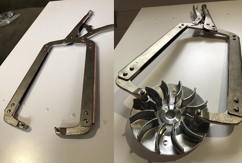

Show your work please, we like to learn stuff
I made this one and it served me well so far...
- tool1.jpg (124.43 KiB) Viewed 2364 times

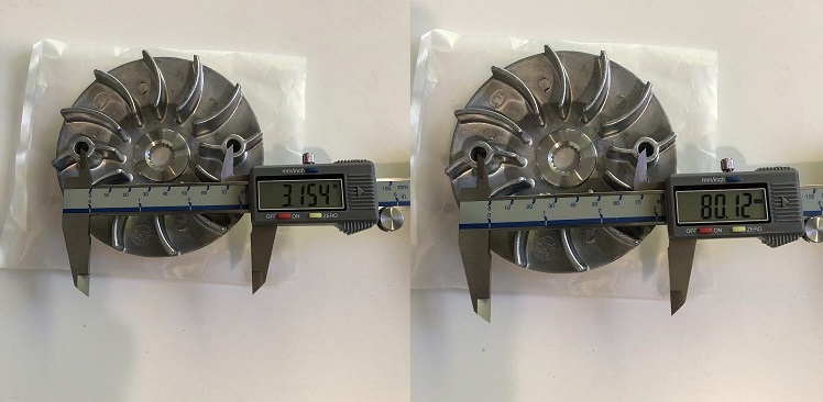

Thats ace!! Any possibility of a ruler over the space between holes??

Very nice- adjustable even !!I made this one and it served me well so far...

80mm or 3 1/8in center to center will do itSinfullsinner wrote:Any possibility of a ruler over the space between holes?
