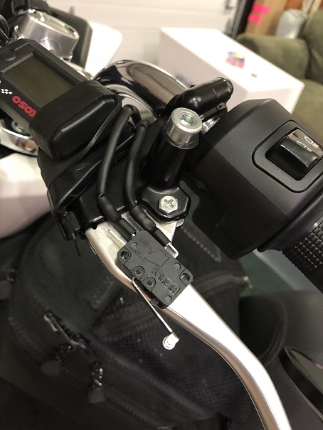

For the archives and future searches here is a crude but surprisingly useful EXTRA horn modification for quicker, easier access. The existing horn will not be disabled 8)
Tools; allen wrench, cross tip screwdriver
Parts; switch, wire, connectors, heat shrink or electrical tape.
Degree of difficulty; LOW
Fashion two 8 inch long jumpers as pictured
1 jumpers.jpg (80.52 KiB) Viewed 62968 times
Attach to switch in (normally open) configuration
3 switch.jpg (42.98 KiB) Viewed 62968 times
Loosen brake lever assembly and swing it down to access two switch housing screws
2 lever.jpg (107.98 KiB) Viewed 62968 times

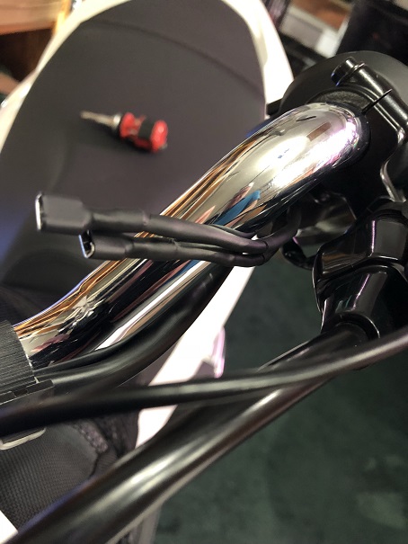

Open switch box housing and remove horn jack connector. Tap horn jack connector with jumpers
4 tapping.jpg (74.25 KiB) Viewed 62968 times
Reconnect jack - route jumper wires with existing harness - reassemble switch box
5 connect.jpg (65.11 KiB) Viewed 62968 times
6 assemble.jpg (88.97 KiB) Viewed 62968 times
CAUTION ; Pull jumper leads OVER the brake lever NOT under to avoid jumpers getting caught in lever actions
7 leeds.jpg (84.07 KiB) Viewed 62968 times
8 mount.jpg (86.31 KiB) Viewed 62968 times
3m double side sticky works great (the grey stuff) to attach new switch to lever where it won't interfere with operations, but is naturally positioned for your index finger.
Now both horn switches will work so you've no excuse....blast away :lol:

It was fun and no harm done to wiring or cosmetics... easily reversed. I was out all evening riding and never once used the horn unintentionally so that's what I wanted to know. I'll keep it ;) but you will never see something like this on motorbikes. Like the plastic bag stuck on the back of every disposable diaper invention...too much liability. Do at your own risk, always
