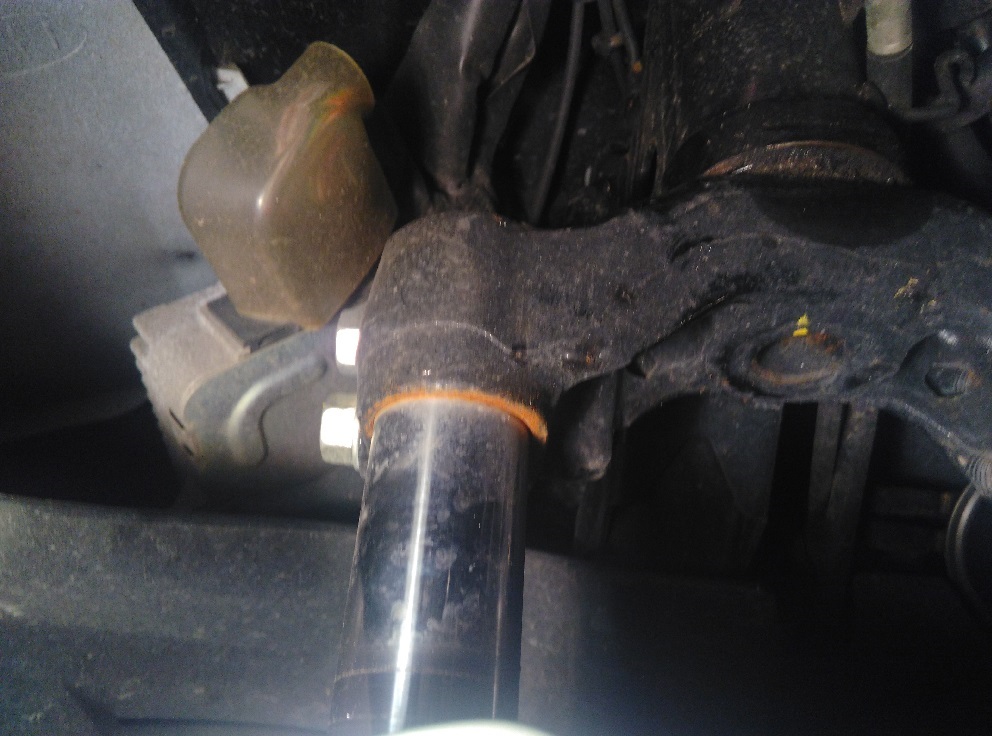

Ralf_CT wrote: Maybe I'm just paranoid, especially after seeing a little more the 1" of fork tube held only by the lower fork brace.
I certainly understand what you are saying by comparison to traditional design. No one has experienced catastrophic failure of the PCX design in this area to my knowledge, even though we've seen many front end collisions. Hope that makes you feel better.

Oh the more you look at this. Wish you hadn't brought to my attention
o_O now I have FEAR!!!!! jk
We have to trust Honda extensively crash tested and continues to utilize adequate molecular quality steel in those two little rings that hold our lives so precariously between bliss and vault. Um... FEAR I have it again!
Admin remove pictures :lol:

homie wrote:Oh the more you look at this. Wish you hadn't brought to my attention
And to think my little two rings look like this + not to mention the rust at the center of the fork...:
front fork rusty dusty.jpg (207.2 KiB) Viewed 5614 times
I'll be removing the front fork all together within a month and put some clear tectyl on those ends just to get ready for winter. I already removed the exhaust last weekend - sanded slightly and sprayed some heat resistant mat black protective paint on it (damn the salty winter roads). Yes, even though it is hot right now -> Winter's coming!

The yoke/stanchion interface will always rust and its not a problem so long as you kep rubbing it clean with an oily rag.
Also keep rubbung the chrome stanchions with an oily rag, its very expensive to fix if they start to get pitted.
