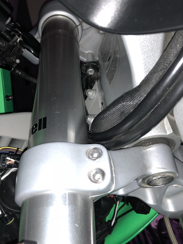

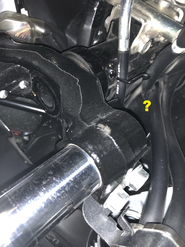

I certainly understand what you are saying by comparison to traditional design. No one has experienced catastrophic failure of the PCX design in this area to my knowledge, even though we've seen many front end collisions. Hope that makes you feel better.Ralf_CT wrote: Maybe I'm just paranoid, especially after seeing a little more the 1" of fork tube held only by the lower fork brace.
PS I've survived some serious pot holes in the Chicagoland streets

Re: Front Suspension Degrade
Oh the more you look at this. Wish you hadn't brought to my attention
now I have FEAR!!!!! jk
We have to trust Honda extensively crash tested and continues to utilize adequate molecular quality steel in those two little rings that hold our lives so precariously between bliss and vault. Um... FEAR I have it again!
Admin remove pictures
