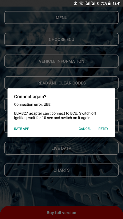

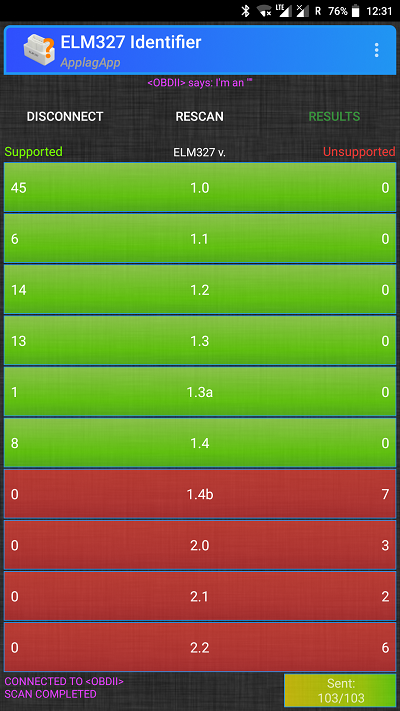

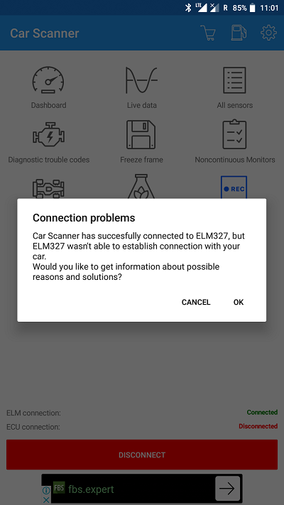

Hi MadSteamer, could you please give me a link to your generic Bluetooth OBD reader, assuming you bought it online. I just got mine but it appears to be a dud.. I tried it on another vehicle other than my PCX and got the same result, so I don't think my 4-pin adapter by Kitaco is the problem.
- IMG_20190214_103832.jpg (161.16 KiB) Viewed 30525 times
- Screenshot_20190214-110109_Car_Scanner.png (62.19 KiB) Viewed 30525 times
- Screenshot_20190214-124155_Obd_Arny.png (311.92 KiB) Viewed 30525 times
- Screenshot_20190214-123147_ELM327_Identifier.png (346.57 KiB) Viewed 30525 times

I've got an OBDLink MX scanner and was unable to get it to work. I've got a few of the ELM 327 scanners somewhere, but I just can't seem to find any of them now. I know I gave the smaller blue one to my brother. But I should have another two or more somewhere.
I'll probly wait until I hear of someome else getting a specific one that works, tho. Been spending far too much money lately.

Found my ELM327 adapter and even tried an HT200 adapter I picked up from Walmart that supposedly had "more PIDs" and/or protocols or something...
Still... *NO PROTOCOL* works with this Lonelec 4 pin adapter and my PCX.
I'm bummed, because this would've been so awesome. Wondering if the OP happens to be associated with Lonelec company and sold a few extra of these to a few suckers like myself. Hmm... :-(

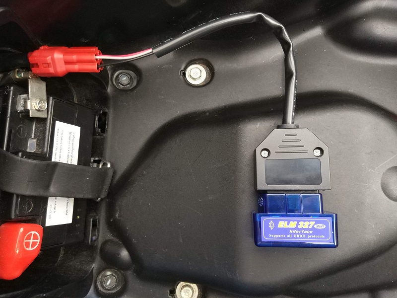

MadSteamer wrote:Hi there,
I thought that I share my latest discovery on connecting cheap Bluetooth OBD2 reader to the PCX. All you need is:
-cable from here
https://www.lonelec.co.uk/Honda-4pin-OBD2-Adaptor
-Generic Bluetooth OBD2 transmiter/reader
-Torque app
You plug the cable to PCX red service port next to the battery and that's it.
You can read all the data available without expensive gauges.
Thx!

Doesn't work on 2017.
I bought the Kitaco Adapter and the ELM BT scanner. No data is transferred thru the Kitaco. my ELM scanner works flawlessly on my car.
I also tried another plug and play aRacer Display but no data. Waiting to hear back from aRacer for a firmware update to get it to work.
