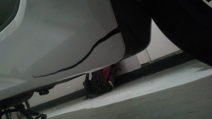

Back home I did an inspection and saw that some of the radiator and back tire was covered in guts/goo. Cleaned it all off - as far as I can tell.
But I also noticed that the right lower panel was cracked.
bunny vs pcx1 - right lower panel cracked
As I use the scoot for commuting back and forth to work I just put some duct tape on and went to work this morning as usual. Upon arriving I did another inspection and noticed that more damage was done than I originally thought.

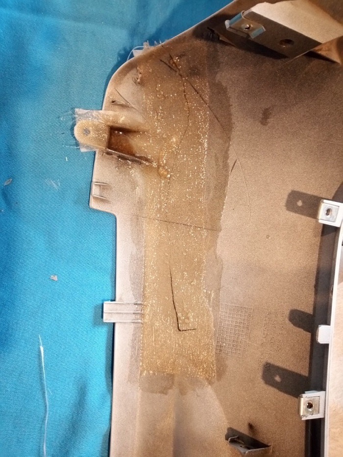

As said earlier I opted for a repair using this fiberglass polyester kit from Motip.
Tools needed:
* a pair of gloves (or make that three pair of gloves as they get sticky and fiberglass is Itchy&Scratchy)
* paint brush
* cutter knife and scissors
* last but not least: a well ventilated area :lol:
The polyester thing I used said; add 2.5% of hardener to the main thing... I just ball parked it and ended up with 2.5%-ish - or maybe a bit more :).

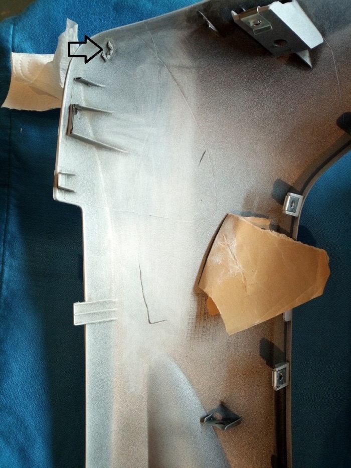

So first of all, take the panel off and clean it (both in and outside). Next apply some transparent tape to the outside while holding it firmly together - no point in a repair if there is still space between both sides.
I did notice there are some fine cracks in the varnish (might apply a new one later on as this might start to crack as well later).
Next, a bit of sanding - also noticed there was a clip which was also broken off - retrieved it though (fell out the panel after I removed it).
After the sanding, cut the fiberglass and mat to the correct size. I attached the clip first using loctite - would be difficult to hold it in place while working with the fiberglass. Prepare this mixture and get to it (it says it hardens after 8 minutes - they were right!). So this is the end result on the inside:
40 minutes wait to let it dry - also a good time to take a break to clear your head from the lovely smell it produces. Next I also drilled a hole trough the fiberglass where the plastic rivet should go into the clip that broke off. Use the cutter knife and scissors to take of any excess fiber glass mat.

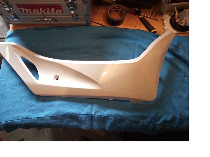

And after mounting it back:
I am pleased with the result, it feels strong again. The only thing is that I think the clip, when pushing in the plastic rivet, gave a cracking sound - but it seems to stay fixed so. I also put the bottom floor thing back in its place as it was also out of position along with another panel that had shifted a bit.
It looks much better as before and especially compared to my ducktape solution I used during this week. As it only took around 1 hour and didn't even cost a thing (got the polyester repair kit for free as I had some vouchers left I could redeem in this particular shop - where I almost never go so this was a good way to spend them) it beats the other otpions which were far more expensive. Only thing left to put in place are two other plastic rivets that are probably somewhere on the street - but they should arrive shortly by mail, and then it is all being held together firmly again.
