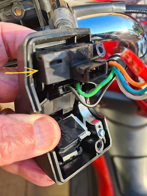

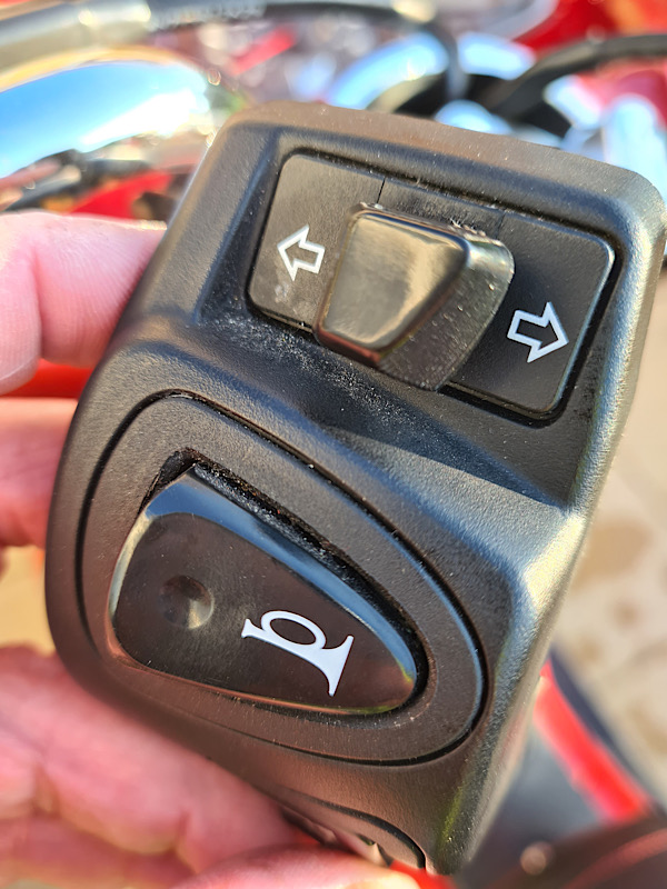

Re: Left Hand Indicators stopped working
Can anyone explain how to remove/get into this part of the handlebar switch unit, please? I want to check the contact points which I hope are hidden in here, since the left indicator lights have stopped working.
Left side indicator lights are now working again!
Although I would like to know how to access the switch compartment at the back I sprayed a little WD40 onto the contacts of the red ‘socket’ before reconnecting then sprayed WD40 down the sides of the actual switch on the front and moved left and right numerous times. To my pleasant surprise the indicator lights now work again when selected.
Many thanks for the help and suggestions offered. Any guidance to access the switch compartment would be appreciated so that I can thoroughly clean what must be dodgy contacts within.
