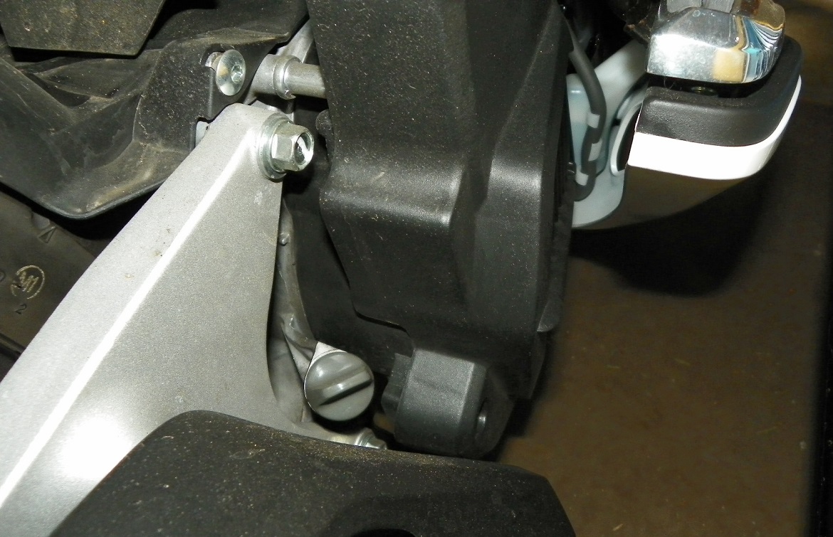

If you look between the rear wheel and the passenger peg on the silencer side you can get a fairly good view of the level in the coolant reservoir. You don't have to take anything apart. I just took the picture shown below today after about a 5 mile jaunt to get lottery tickets and a view of the shoreline (in between the rain drops). If you look carefully you can see that my coolant level is just below the top guide for that hose (PCX is on center stand). When everything cools down it will be slightly lower. . .about half way between the high and low level marks. :geek:

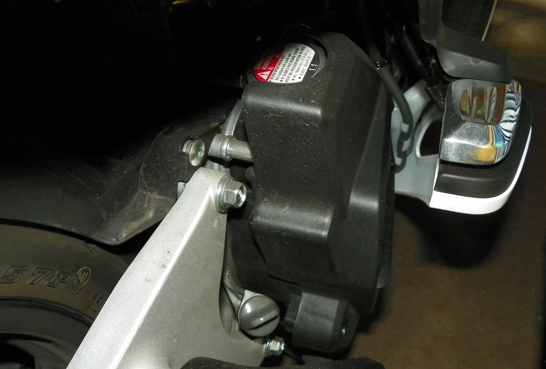

Here is another pic showing the top of the radiator behind the cover. I know you can look at the level through the hole in the panel side but if you just want a quick look without getting to ground level it's an option. Also Homie did a video that is very helpful indeed. :geek:
