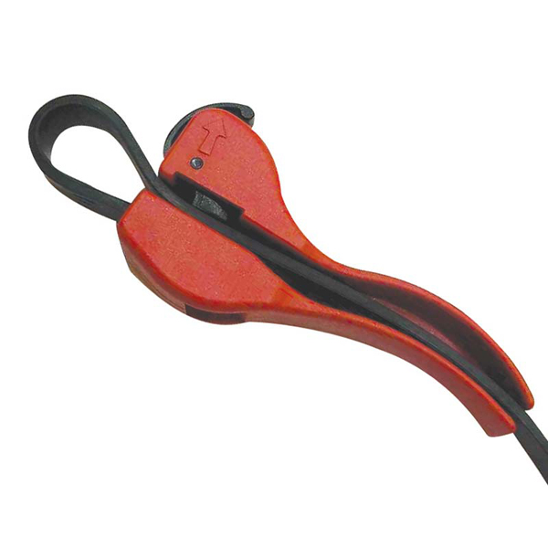

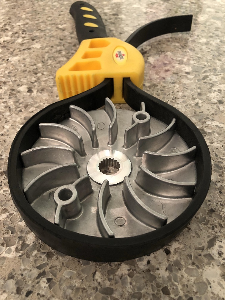

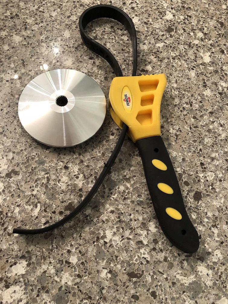

A large (rubber band) oil filter removal tool to hold the face for re-torque.

I am all for using something along the line of the strap, so please tell me how it works with the belt already on the variator. Is there enough room to put the strap on and hold it out of the way while torquing the nut? :ugeek:
I may go ahead and purchase one of those straps if it can fit on the drive face and actually be tightened up without getting in the way while i torque the nut. Any preferred type?
Re: Torquing the ncy drive face.. lil advice please
The exact same one I use in my long boring video's to hold the NCY face whilst torquing the vario nut. The little gripper is of little use but the large one will serve to hold the outer rim of the face then wedge the handle. It may slip off a couple times but you can manage it.

Homie, would you mind pointing me to one of your videos where you use the strap for the NCY drive face, please? I am trying to understand how to use it with the belt already on and the nut secure but not torqued yet. It just seems to me that there wouldn't be enough surface to grasp on the drive face because of the belt interference. I have installed several of these kits now and have always had a problem with tightening the nut to torque spec. Even a photo of the strap wrench secured on the drive face would give me a better understanding. Thanks.
Here you go Mel, and yes after fully assembled and with your torque wrench ready apply the oil filter grip in the proper direction. Don't forget thats a wet torque (light coat of motor oil on the threads)
A little awkward to do by yourself but if someone holds it the 44 ft lbs does not exceed the bands ability to hold tight.
