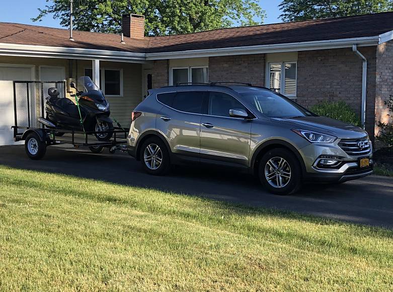

Here is what I did.
I ended up buying a 5'x8' trailer from Tractor Supply instead of renting one from U-Haul. I fastened 4 D-rings to the floor to use as anchor points. I also screwed at $13 motorcycle wheel chock at the front of the trailer. I got it at Harbor Freight. It turned out to be better than the more expensive ones because I had to spread the opening as it was rubbing again the brake disk, being that the front wheel is considerably smaller (13") than a typical motorcycle wheel.
After loading the bike I ran 2 ratchet-straps forward from the handle grips (1 on each) and two ratchet-straps from the lower mounting point of the rear shocks, holding the bike forward. I did not use the center or side stands. It traveled without moving an inch for the 520 mile trip, some of it over some fairly bumpy roads.
I used 4 straps in total and I suppose I could have double them us in case one broke, but that is why I have insurance.

I think you did a good job. However, keep in mind that when to vehicle moves forward the scooter will want to move backward, but when you brake the bike will want to keep moving forward. With that in mind, tie the bike for both forward and rearward movement. You also want to make sure that the bike will remain tied down in an accident. Consider a strap across the seat, making sure you ratchet it so that the rear shocks are compressed some.
Everyone has their own way of doing things, so all I can do is try to point out what the bike will want to do. I spent much of my lifetime tying down cargo on aircraft and aircraft on ships. It is easy to be surprised when you thought you had everything secure.
