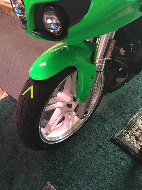

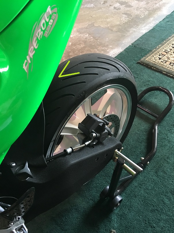

Mel, the 90/90-14 was the stock front tire/tyre/terr if i'm not mistaken. So a 110/80-14 would fit nicely, it would be wider but not as tall. Since its on the front you wouldn't put your speedometer off so you could do that but it would actually be wider than the stock rear tire/tyre/terr which was 100/90-14.
Disclaimer on this information, you need a second opinion on this. I know you don't put rubber made for front on the back and vs-versa because of thread patterns designed to shed water and gather up when braking. If you ever noticed thread patterns on motorcycles are opposing in angles... critical to staying alive.
