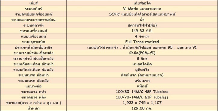

Saw a 2018 PCX up close today at the parking, first thing I noticed is that the tires are slightly wider.
I then checked online for its specs..
I found out that the new pcx 2018 comes with 100/80 - 14 front and 120/70 - 14 rear Michelin City Grip tires..
Now, I want to change my tires to that sizes too..it just look balanced and good in my eyes.
Who else loves this? :ugeek:

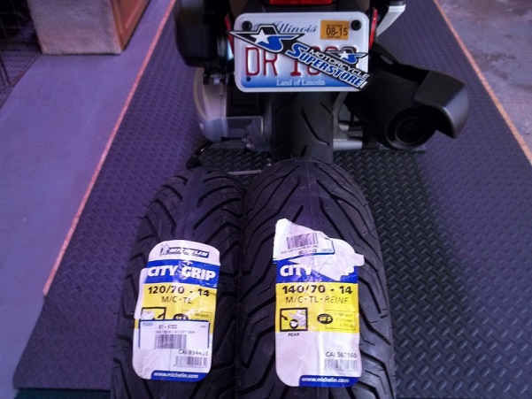

I'm running 110 at the front and 120 at the rear. No modifications were needed at all, and the above specs should be fine on any stock PCX.
Slight mods (in fact a some spacing of the rear fender) needed if someone wants run 140 at the rear.
Re: New PCX 2018 tire size
To put the 140/70-14 rear Michelin on PCX you need to make this simple modification.
If you like wider tires you can put the 120/70-14 on the front without any modification.
Here are the results of oversized tires/tyres
1. Speedometer will be off a couple miles per hour than actual, GPS will confirm.
2. Loses 4 mile per hour off top speed due to increased mass turning.
3. Stability increases, softer ride and a bigger bike feel in my opinion.
4. On rare occasion a pebble ridding the tread will rattle between the front fender and tire/tyre.
(this does not happen on the rear but its very startling the first time you hear it)
Bought my set of city grips from the superstore, never going back to stock rubber.

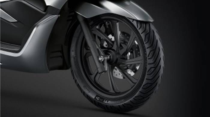

update: the 2018 PCX is using a much wider wheel size than the previous years PCX models.
Honda said I should upgrade to wider wheel size if I want to use the new 100/80 - 14 front and 120/70 - 14 rear.
I doubt it is really necessary. But at least now we have more options..
