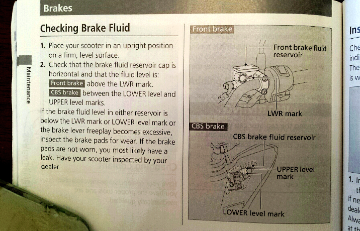

Crazy right? I asked the very same question when I got my '15. What's that "porthole" all about? Once I found out, I then wondered IF any fluid was in it :roll: I needed to shed some light in there. The fluid level turned out to be fine after I realized it was Clear in color! Lol
This from my 2015 owners manual: (sorry, it's a rainy dismal day here)
