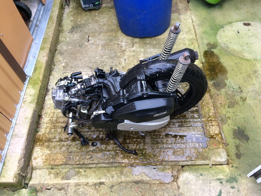

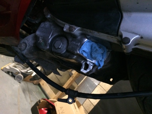

After my recent hit and where a car failed to give way and ended up with my clipping a kerb which caught the centre stand and ripped it off the crankcase taking a chunk of the crankcase with it, I’d thought I’d finally get round to giving my every day PCX 125 some love.
It’s a 2013 with 17,000 miles on it.
I tracked down a correct JF47E engine which I fitted, did the valve clearances before installing it, then once it was in changed engine and the gearbox oil.
Spark plug and air filter then changed the variator rollers for Malossi 12.5g ones.

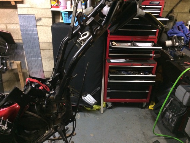

Once the scoot was up and running I finally tackled the corrosion on the frame and fuel tank and gave a lovely gloss coat of black rustolium. Then fitted a full new Honda original panel kit from Max Motorcycles.
Fitted Renthal gold handler bars and LED side light bulbs.
It’s like having a new scooter again, really pleased with it. :D

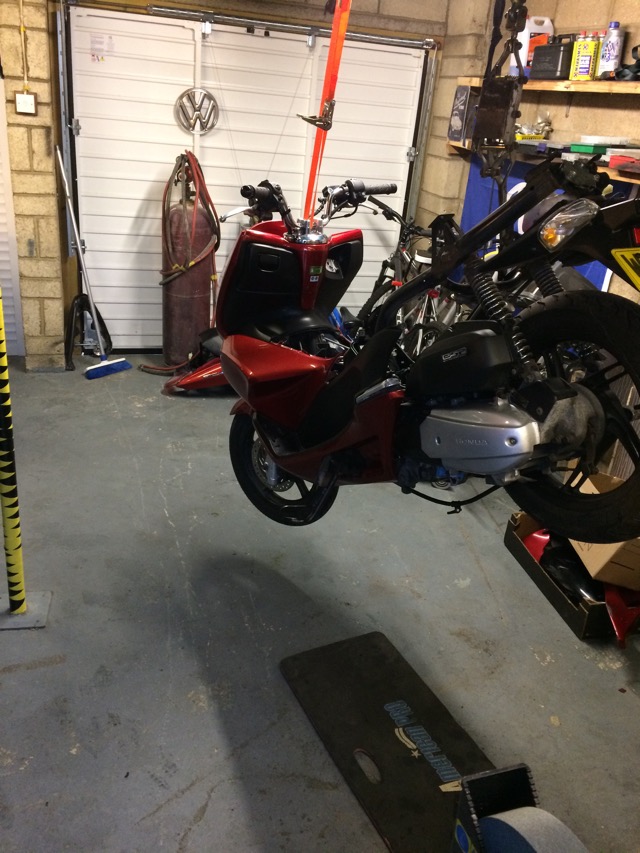

Your "swinging bike lift" is quite similar to what I usually do with my PCXes.
Unfortunately my larger bijes are too heavy to suspend them from the beams, so I had to make a project table to comfortably work on them.

Yes hanging the bike from the garage roof is my preferred way to work on the PCX I like that I can get it as high as is comfortable and have both wheels off, although your platform does sound interesting. Do you have a photo?

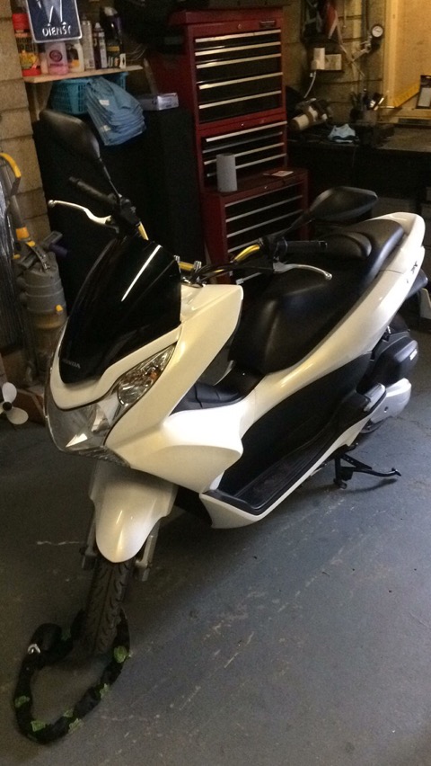

I am a little confused. You have a white PCX in the first picture, but the other pictures have a red one. Please explain. By the way, since you had it opened up, why not change the variator itself. The Malossi one would have given you a little more top end.

Mel46 wrote:I am a little confused. You have a white PCX in the first picture, but the other pictures have a red one. Please explain. By the way, since you had it opened up, why not change the variator itself. The Malossi one would have given you a little more top end.
The first photo is the finished bike I’ve changed it from red to white, I’m hoping that white is easier to see and stops me getting knocked off for a while.
I’m happy with the top end of 60-65 it’s more than enough to keep up with the trucks in lane 1 of the dual carriage way on the way to work :)
