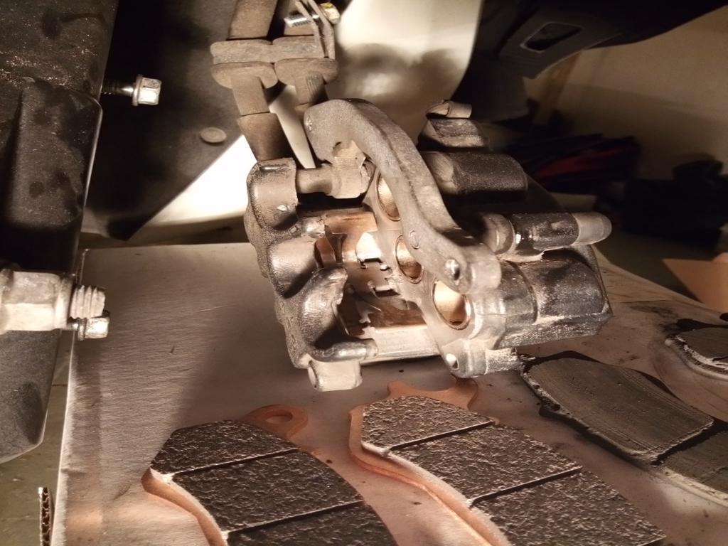

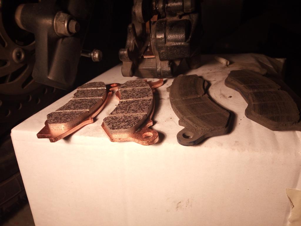

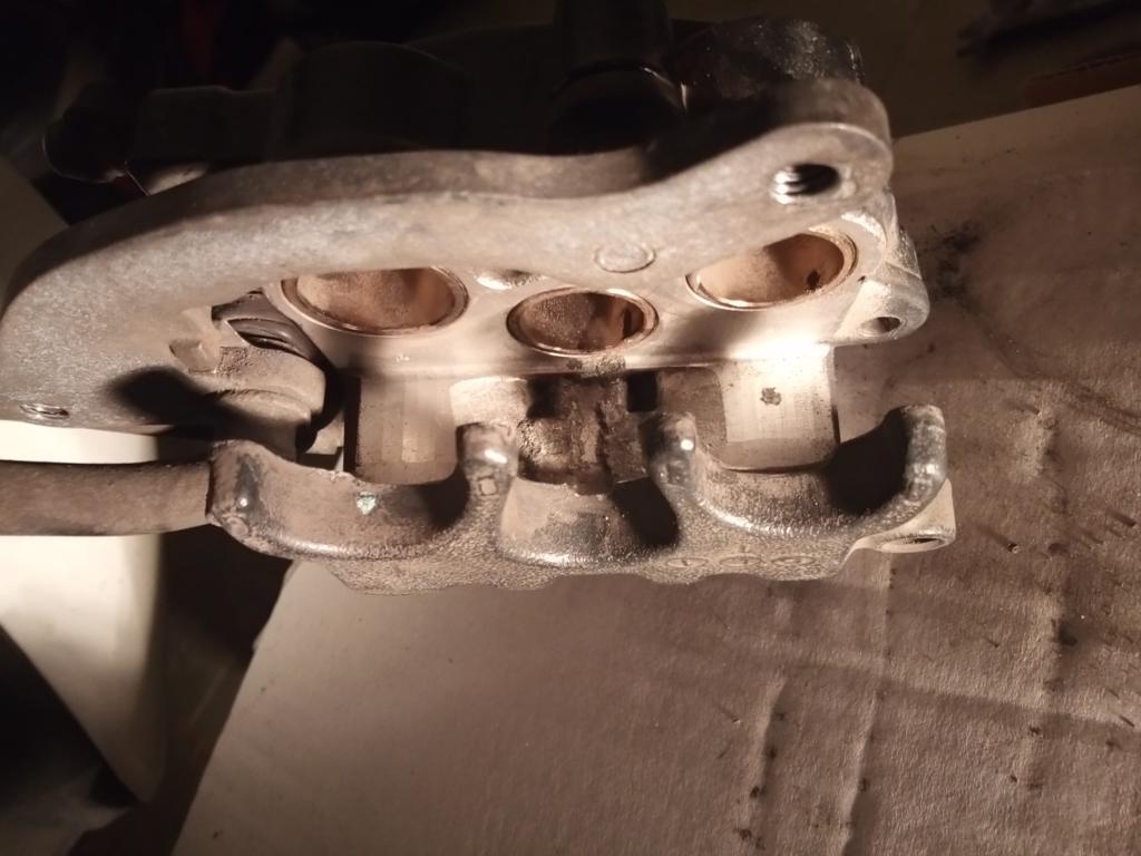

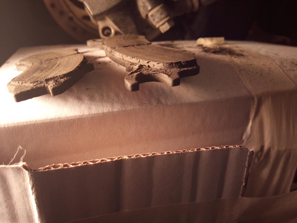

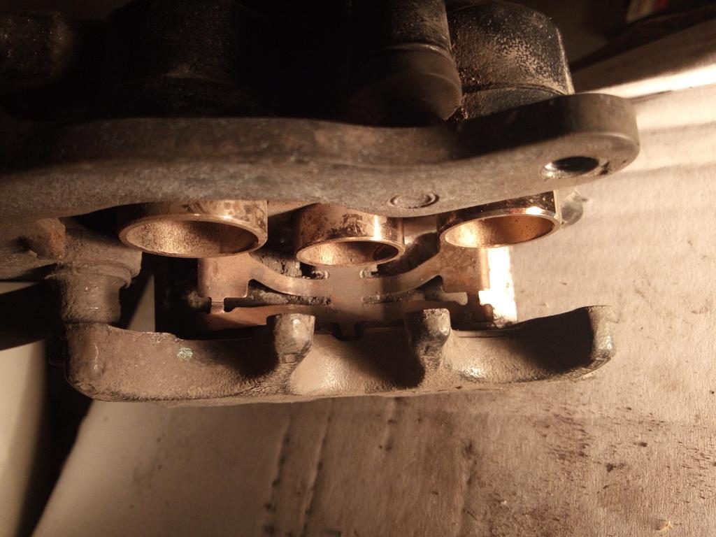

iceman wrote:Had to change the front ones at 13,500 miles (3.5yr's+ riding) as I had been experiencing a 'scratching' noise once per rev for some weeks and thought it must be the pads (did not check just bought new ones - £12 for EBC ones delivered from Ebay / £20 the same ones collected from a Honda dealer). I was basically scraping metal on metal as there was a fraction of a mm left on both front ones!
A good sign they need replacing is if the level in the rhs top reservoir drops significantly from what it was new - usually you do not loose any brake fluid so if it goes down a lot, something is wrong. Mine fluid level rose to where it used to be with the new pads fitted, which being 5mm width each were hard to install due to the effort needed to push the three pistons home (even after cleaning). It's good to remove and clean them every year or so as I found, leaving it so long proved tricky cleaning the pistons and rubber stuff.
Agree with the fluid level. I had to change mine after only 6000kms. After disassembly I noticed one of the brake pistons was not engaging. In fact one of the brake pads was completely worn down while the other side was not. Also, the one that was worn down was not worn down evenly; the front side was almost completely worn off while the 'back side' was still in good condition. Probably because one of the pistons was stuck - guess that is what you get by commuting every day even when the roads are quite salty. I cleaned the whole brake systems and made sure all pistons were engaging again. Mounted some new brake pads and now, with some occasional royal brake cleaning fluid spraying- especially after riding on salty roads they are still going strong and more importantly evenly after 13000 km.
Below some pictures; says more than words:
You can see the uneven wear, top left side is clearly worn much more (guess it was metal to metal to be more specific) then top right side, bottom pad is still fine...
After taking them out.
After a bit of cleaning it still looks quite dirty...
After some more cleaning and making sure all pistons were engaging again.
And finally the new pads vs the old pads; still fine after more then 13k kms.
I now inspect them regularly and clean them quite often with brake cleaner fluid, it's nice to be quite fast off the line but also nice to be able to stop when it's needed.
