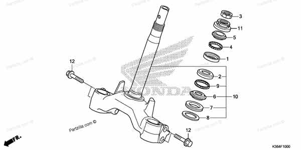

I had on my PCX similar "klick" sound when I used only front brake and stopping to standstill. The problem was a loose steering bearing (image - parts nr. 3 and 11).
Grab the steering and the fork and try to move it forward/back while you have the bike on a center stand and someone siting on the rear seat (that way you should have a front wheel free in the air).
