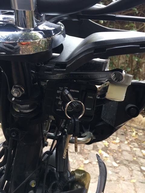

I can't feel any significant play in the steering stem. There is however a faint squeal when i turn the wheel left to right with front wheel lifted from ground. It will need greasing at the minimum. Now that's going to be fun. A member of the french PCX forum had to dismantle half his scooter to reach for the steering stem, he was not happy at all...His pic below
- colonne direction.jpg (116.6 KiB) Viewed 8399 times

Follow-up: There is no play in my steering stem. However i do have a "flat spot" dead center when turning the handlebars with wheels lifted. So i will replace both bearing and races, waiting for parts to arrive...

I've just spent from 11h20 until 17H45 non stop changing the bearings and the races with a friend who's a retired mech. I'm bloody exhausted and so is my friend - I'll post some pics in the next days.
You have to dismantle everything on a V3. Never swore so much in my life. Now i'm left with a couple broken tabs and 3 bolts I've no idea where they came from...
When we took the front wheel off with the forks , bike lifted it was just terrible turning the steering stem. if felt completely stepped and rough - something to be felt to beleive - even though that did not seem obvious while riding. Well it's obvious now that I am enjoying a totally new bike and that's great but frankly i hope i'll never have to do this again.
My bike PCX 125 V3 frmo december 2014 with almost 20.000 kms.
My back is hurting so enough for now, cheers
