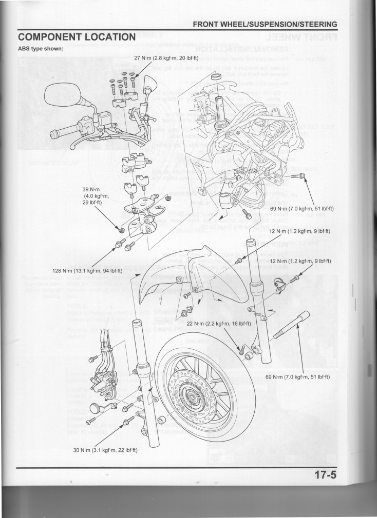

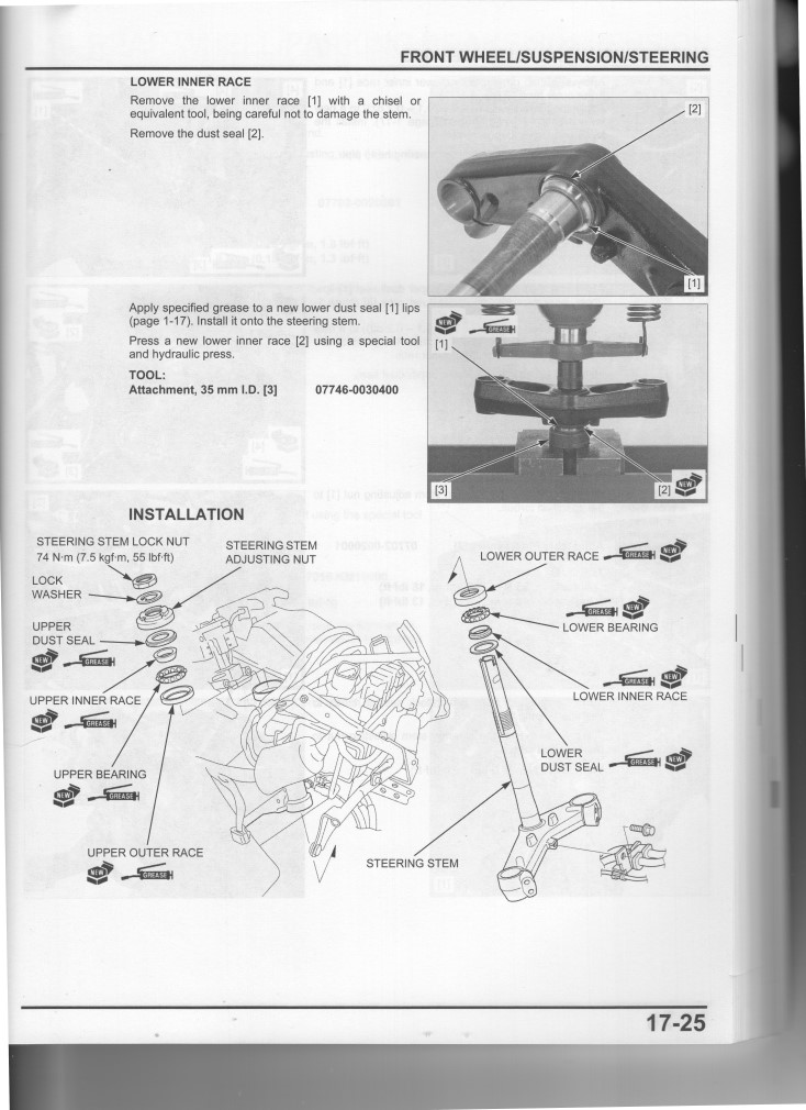

The headset bearing needed adjustment, anyone have the torque settings for the locknut and the bolts?
2013 Forza 300
BMW S1000XR
KTM 250 XC-f
Suzuki Van Van
GeorgeSK
Posts: 986
Year: 13PCX,15Forza
Color: Both Red
Location: Danvers MA USA
Re: headset adjustment
Post by GeorgeSK »
Steering Stem Locknut is 74 N-m or 55 ft-lb.
knick620
Posts: 17
Joined: Sun Dec 10, 2017 3:17 pm
Color: grey
Location: UK, London
Post by knick620 »
Thanks GeorgeSK, thats tomorrows job sorted.

....and thanks to Davenowherejones for the pm, as a newbie can't pm back yet.
Post by aguim »
First, removing the stem locknut (55lbs torque) requires a very deep special socket, 32mm octogonal,
unless there's an equivalent replacement available.
Under that is the adjuster nut itself (initially torqued 15 lbs, then loosened, then finally torqued 2lbs,
no more). Again, a costly special tool apparatus is recommended -but not really needed (I tightened.
it using an old, short Yamaha shock spanner, to 'around' 2 lbs (and it has worked just fine for the
last 13,000km).
I found most of the front end bolts/nuts to be grossly overtightened, not loose in any way. Used
anti-seize everywhere and tightened them more reasonably

knick620
Posts: 17
Color: grey
Post by knick620 »
None of the above post makes sense to me?
I had enough info to loosen the nuts and adjust the bearing (I used a 32mm crowfoot spanner with a torque wrench on a bar), I didn't have the torque settings, but a pm and the pages from the manual were more than enough, thanks for confirming the detail though.
The job is complete and it has sorted out the problem.
