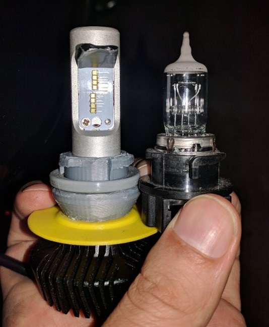

LED guide, my findings.
I would like to share what LEDs I have used so that you can find the right ones the first time. So, I have started this thread to share my LED headlight retrofit and other LEDs used on my scoot, a 2013 Honda PCX.
I uploaded an stl file to thingiverse of a 3D printed socket used to retrofit an LED bulb, that was made for a different type of vehicle, to fit my PCX. It is the first attempt with a H4 type LED bulb. The high beam is useless with this type of bulb, but low beam is plenty bright. I'm working on version number 2 that will hopefully have a better result. I'll add some before and after photos of the light beam pattern in the following weeks. That way you all can get a better Idea of the effectiveness of the LED bulb.
https://www.thingiverse.com/thing:2707796 I will update the content of the thingiverse post with version 2 of the LED retrofit.
I will add more content like what amber LEDs I used for my turn signals, what led flasher I used, and add some photo comparisons.
Gil
Gil

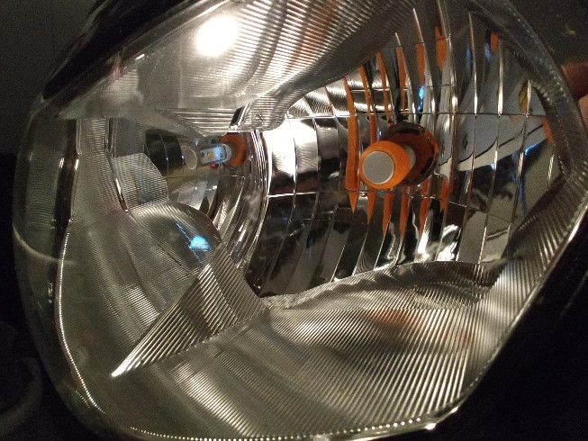

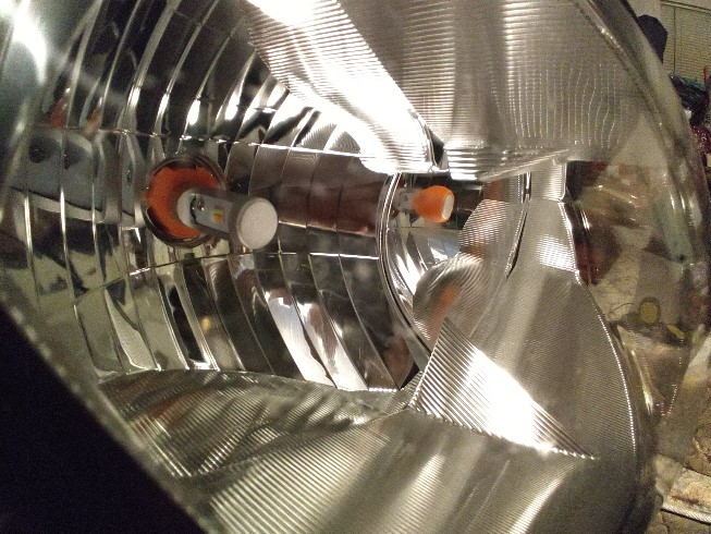

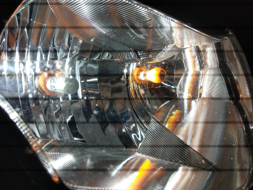

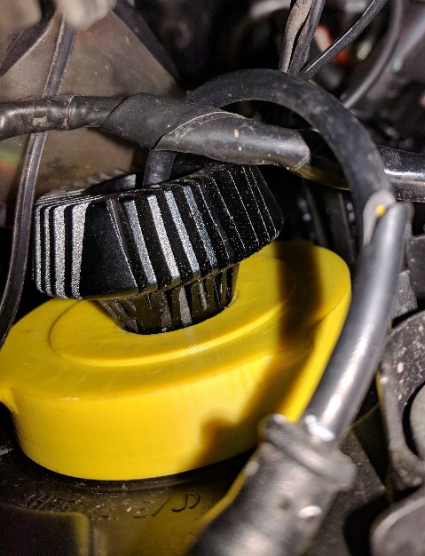

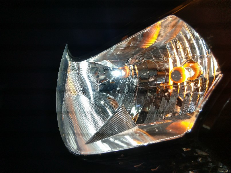

Current State of the LED headlights.
The LED Headlights
The goal of the project was to install LED headlights with good light spread and to be able to reverse the mod, so no cutting of the bikes electrical harness would be involve.

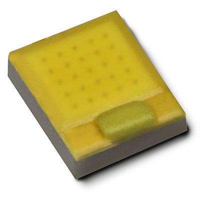

The result of all my troubles is a somewhat OK light pattern of the headlight beam with the low beam. The High beam is is just all over the place. The LED unit itself is too bright. It uses 8 Philips Lumileds Luxeon Z ES chips per bulb. 8 for low beam and 8 for high beam, on each bulb. The LED bulbs are from China , so it's thoughtful that they used real Philips LEDs.
https://www.lumileds.com/products/high- ... uxeon-z-es

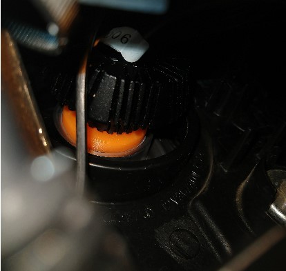

These following pictures are of the LED lights mounted on the scoot. Besides the LED bulb socket adapter I printed a dust cover for the rear of the light housing and a socket adapter for the stock headlight plug, making it a plug and play affair.
Version II
I'm already planning version 2 with a different LED bulbs.
I found them on ebay, so not too sure on their quality, also they are two color bulbs.
The placement of the LED are close to where they should be, I'm hopping that the low and High beam will be close to stock light pattern.
In conclusion
That's where I'm at. The retrofit of the new LED bulbs should be quick as I only need to modify the 3D model files to make the new LEDs work.
Will update with the results.

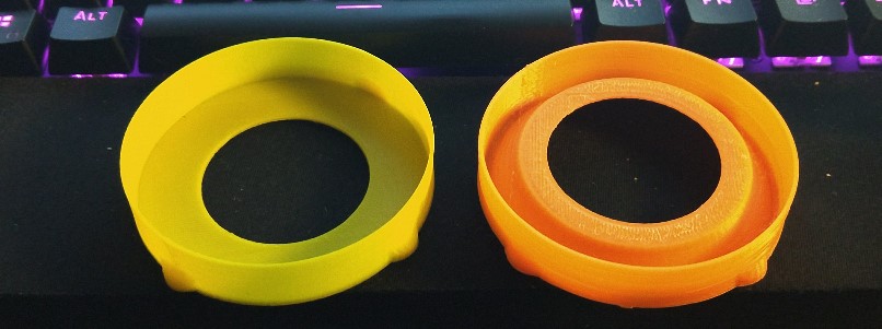

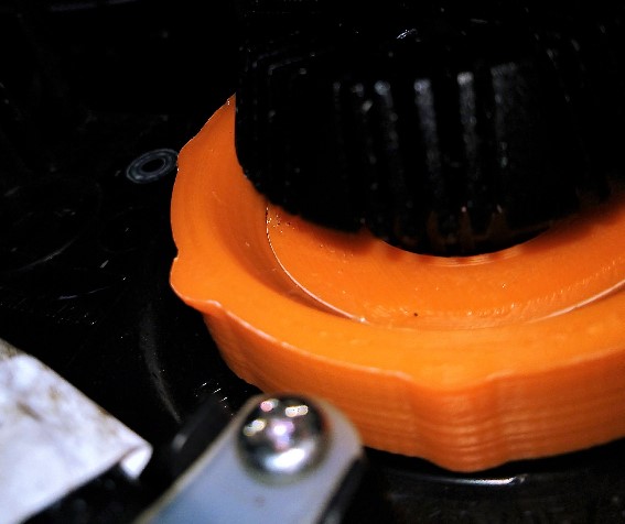

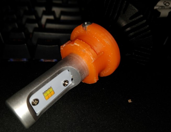

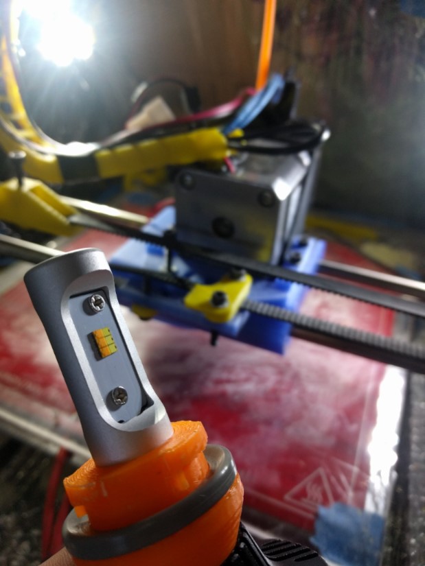

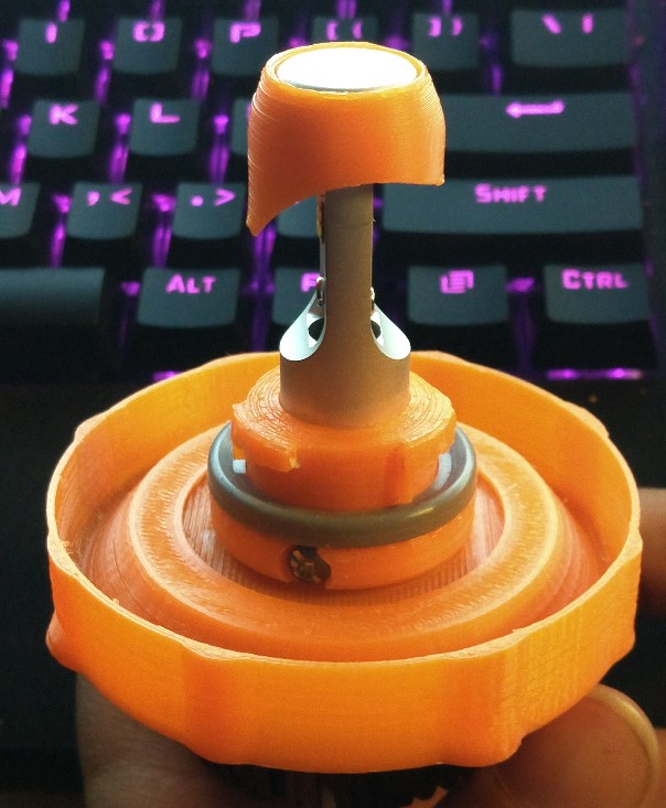

Working on the adapter for the new LED lights.
Printing a newer prototype.
Gil
Gil

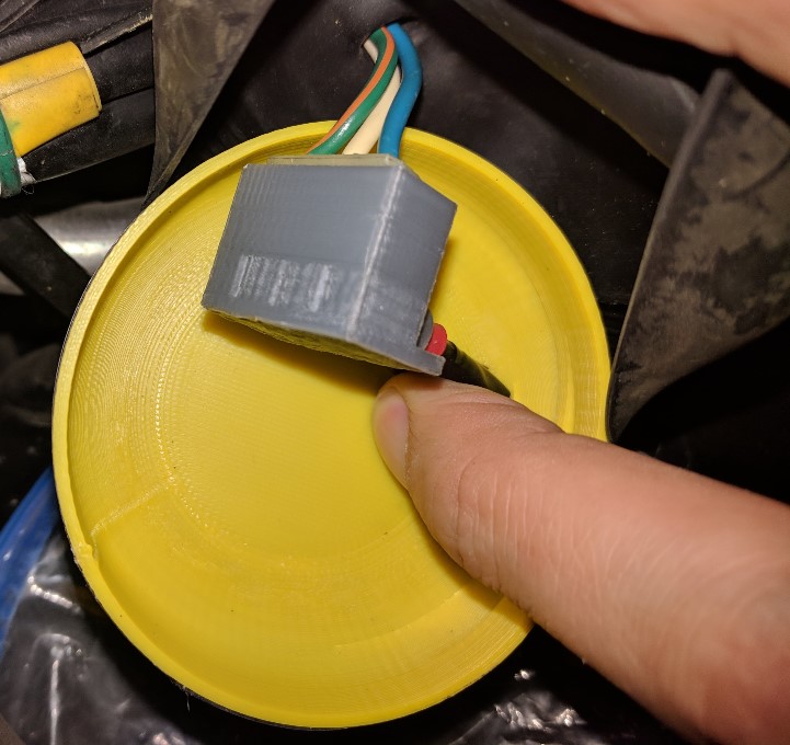

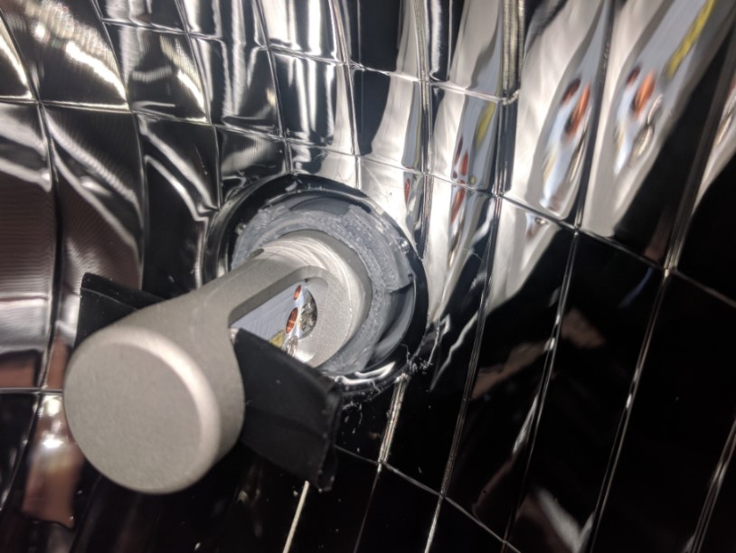

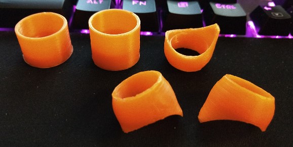

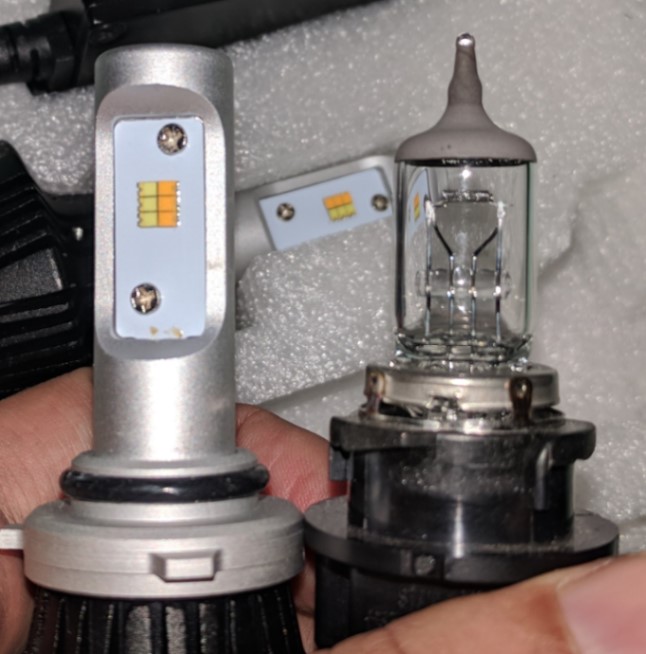

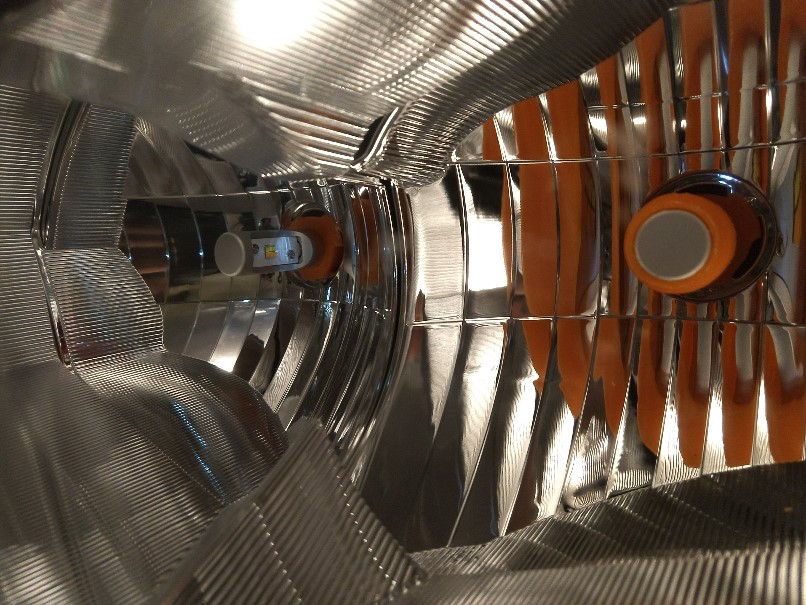

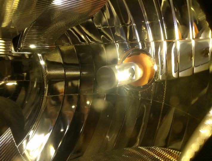

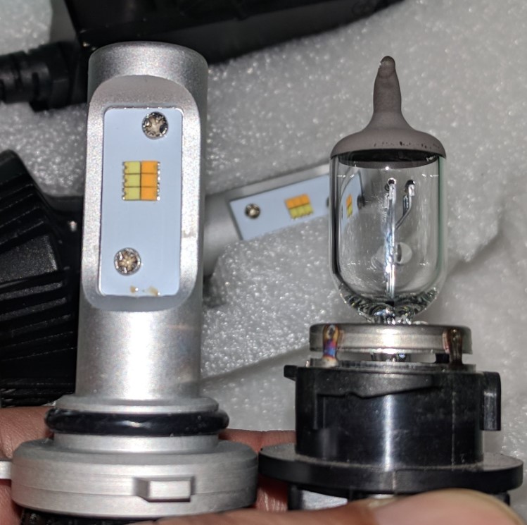

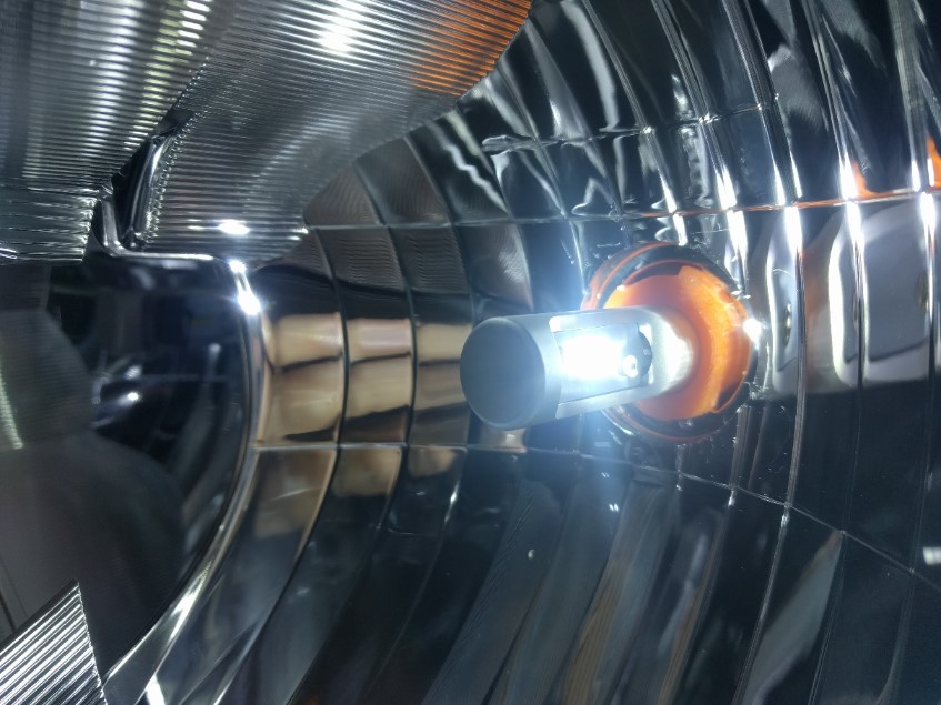

It's looking promising. I installed one LED light and powered it up. The light pattern projected on my garage wall looks similar to the OEM pattern. There is a clear difference between the low beam and the high beam. I won't know how good it is on the road, until I wire it up to my scoot. The wiring is going to be the more difficult part. These LED bulbs were designed for 9006 headlight housing, so it doesn't have separate wiring for low and high beam. The LED driver only has to terminals to connect the power too, positive and negative. It switches between white and yellow LEDs when the power is turned off and on. That won't suffice my lighting needs. I'm looking to use some LED drivers from ebay to solve this conundrum. It's looking promising as wheal. I bought the 350ma version and have the 700ma drivers on order.
https://www.ebay.com/itm/10PSC-350mA-1W ... 2749.l2649 Anyway here are some pics of the LEDs in the headlight housing.
Gil

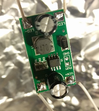

I forgot to mention that I got the LED light from an ebay auction for $11. I looked up past auctions of the same lights and they go up too 20 USD. The regular price is $39.99.
I also e-mailed the seller about the LED drivers, hope to get a response.

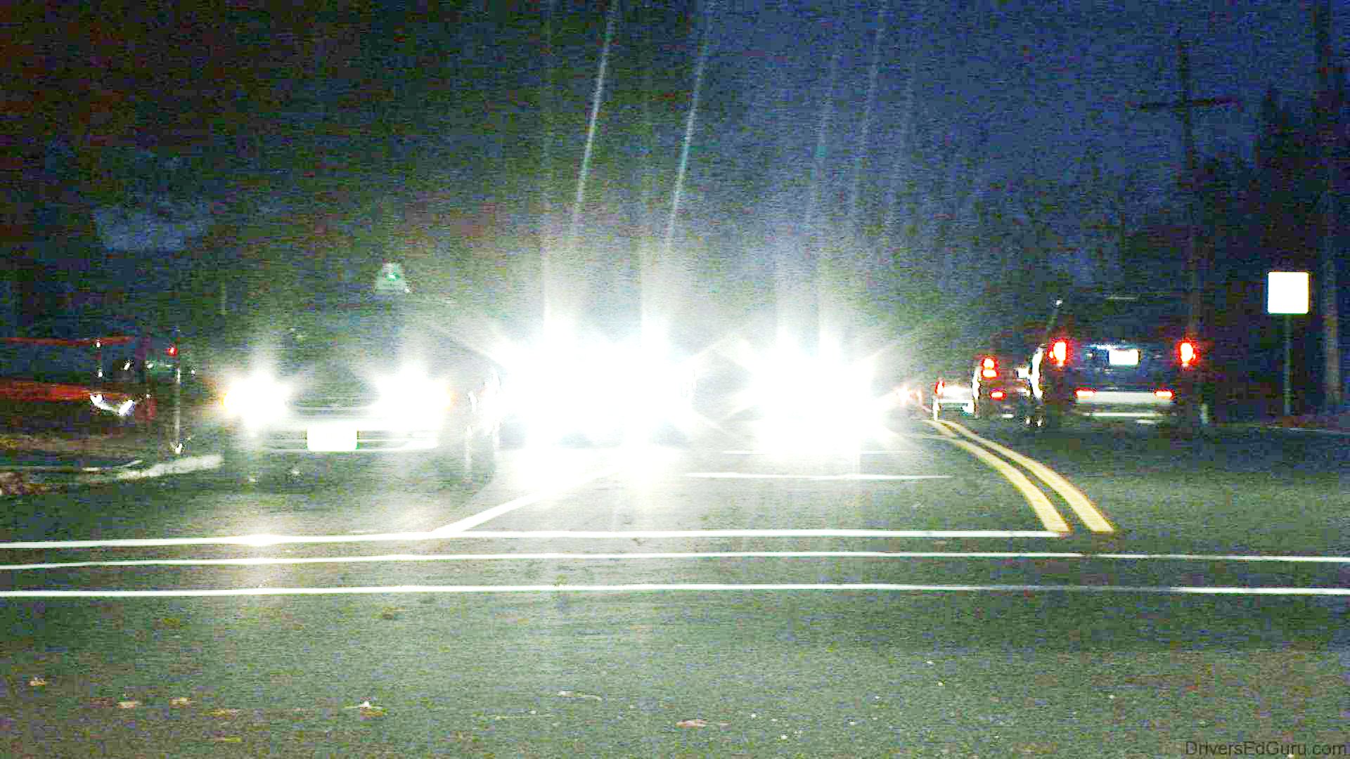

Example of aftermarket bulbs in OEM lenses not designed for the bulbs.
Left: Properly adjusted headlights. Note the car is the closest of the three and the headlights should be the brightest.
Center (farther away), Right (even farther away): Properly adjusted headlights for the OEM bulbs, but using aftermarket bulbs without correcting the adjustment for those bulbs. Notice how hard it is to tell how far away they are. This is called "glare," when the light blinds oncoming drivers.

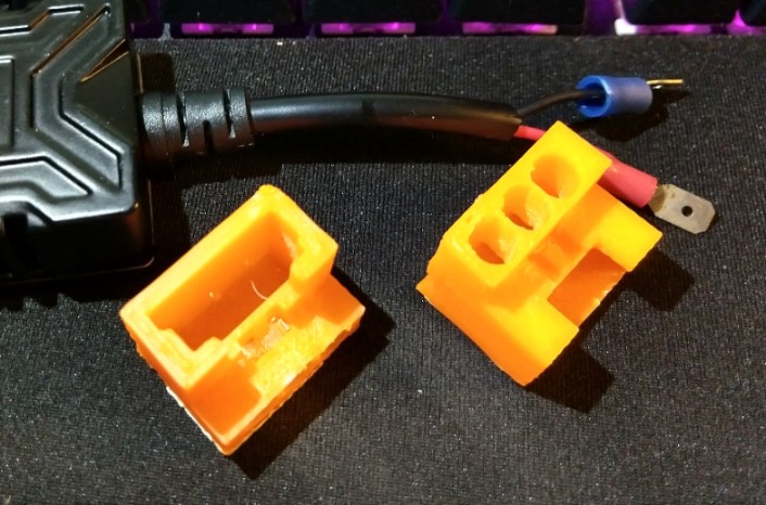

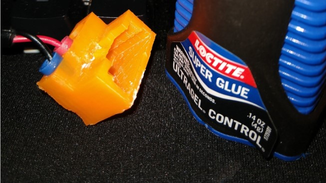

Update:

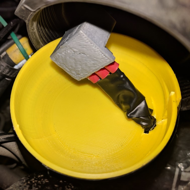

I have updated the led plug adapter. After some spade connectors and some crazy glue, we have wiring done. Although Hi/Lo lighting wont work properly, but it's a temporary measure.Now to install it.
Gil

Looks awesome. After you get it perfected you gotta sell the adapters and connectors. Im in buying ur stuff.

That's quite the design! Since LEDs don't generate too much heat the plastic should hold up well. I admire your ingenuity!

Update: Light shield
Today I worked on the light shield for the LEDs' to block the direct view of the LEDs', as thy are quite bright. Now, as for the color of the plastic, I have a natural ABS filament spool that I might use for the Light shield. It might look "cooler".
Gil
- Gil
- Posts: 623
- Location: Watsonville, CA
Re: LED guide, my findings.
Light shield in action
Took some pics of the light shield in action. Gil
Close up of light shield and its intermediate designs.
Gil
Gil

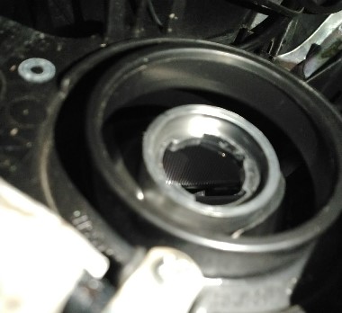

Dust cover
Finishing up the dust cover for the headlight housing. My only concern is the free movement of the chrome reflector when adjusting the headlight beam. Gil
