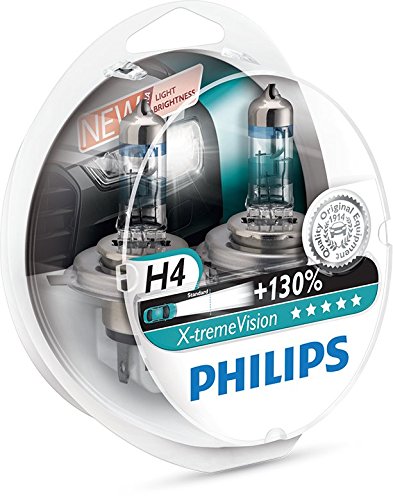

Do you have an image of the bulbs?

Gil wrote:Do you have an image of the bulbs?
This could be useful. The bulbs are rated at 450 hours, and flashing them to pass will shorten that life. There's a good chance one popped and took a fuse with it.
Gil
Bought from amazon, I replace them as standard in my vehicles.

gn2 wrote:
knick620 wrote:I upgraded my headlight bulbs to Phillips +130%
Are they definitely 35/35w halogens...?
Have you tried putting the originals back in...?
Getting to the route cause, it looks like they are 60/55w, though that what also what was in the scoot. When i tried one old one new the difference was significant, though it was only increasing the load by one bulb, clearly with 2 bulbs at 60/55w it has overloaded the lighting circuit somewhere, its just working out where.
Whe I put the originals back in there is still no light. So either fuse, relay or switch?

Chances are you'll have blown the 10A headlamp fuse.
120w/12v=10a
The stock bulbs look like H4 but are only 35/35w
70w/12v=5.833a

You could look at getting an LED headlight bulb retrofit. The H4 type bulb is the only one that I have seen being offered as an LED bulb retrofit by a major manufacturer. Phillips is that one company, it's pricey though, as it's only sold outside the US. Here is a review of the H4 bulb. http://www.xenondepot.com/Philips-12953 ... w-s/62.htm
The important thing about the Phillips bulbs is the position of the LEDs that allow for a great light pattern.

Stock canadian model has 35/35w bulbs, protected by fuse G (10A), fusebox B (under the right glove
cover as said above). So stock demand is 2x35 =70w/12v = 5.8 Amps. No way that fuse could
stand 2x60= 120w/12v=10 Amps for long.
There is no headlight relay.
I have no idea how UK's Pass system is wired, but it is highly probable that you're asking too much from your H/L fuse. +130% better, not really.
