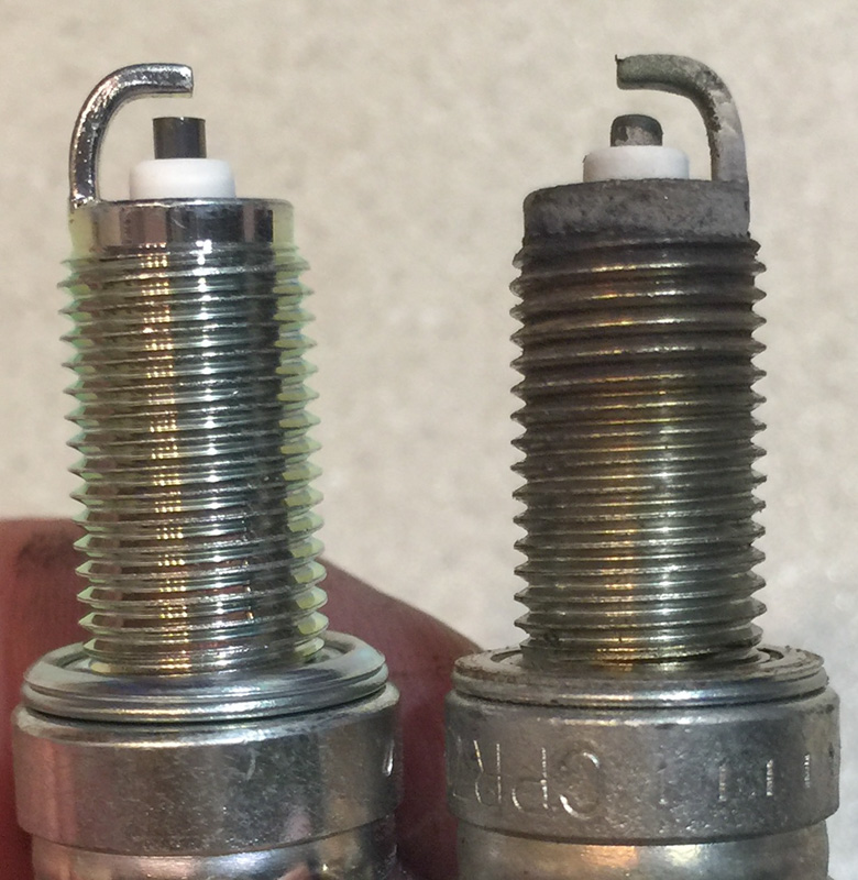

Post by TheMaverick »
Book says to change every 8,000km, but that just didn't make any sense to me when car plugs are good for 100,000km+. Finally changed it after 34,000km - was still going just fine but I didn't want to push my luck forever. Gap had opened up from the recommended 0.8 to 0.9mm recommended range to exactly 1mm - and the center electrode was a little eroded - but other than that it was perfectly fine.
Will be interesting to see if there's any change to power levels or economy.
Re: Finally changed spark plug at 34,000km
Probably won't see any difference.
I would give the outer electrode a tweak and stick it back in.

gn2 wrote:Probably won't see any difference.
I thought about it, but they don't cost a lot and I'm trying to "zero time" a number of components that I can now forget about until 67,000km.
Post by Slowinitdown »
Has faired pretty good for 34K am glad Honda put a flap to gain access makes for an easy job
