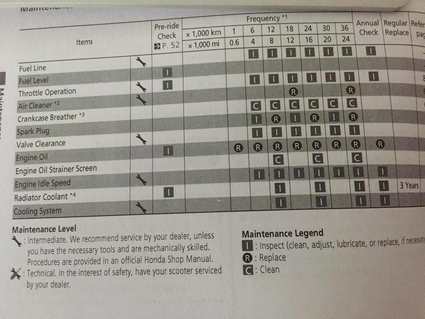

Depending upon which side of the pond you live on and which PCX owners manual you choose to read the valve checks can be either at 600 miles for the initial and then every 2500 miles after that or at 4000 miles and then every 4000 miles after that. I am going by the U.K. one for the 2017 (which mine is) and going to do it every 4000 miles. It's a personal choice. I've got just about 1900 miles on it now and have seen good consistent performance and no changes in valve noise. I changed my engine oil and cleaned the strainer screen at about 600 miles (using the recommended Honda oil) and changed my Final Drive oil early at about 1000 miles (also using the recommended Honda oil). I'm quite satisfied with the PCX overall and so far so good knock on wood!
Here's some pages from the U.K. owners manual depicting the maintenance schedule I read on this forum months ago. That being said my SM and OM both reference the 2500 mile intervals. . .go figure.

I am in the USA. I am wondering if the frequency is different in the UK because of the idle-stop feature, which is off on our USA model, thus increasing engine hours.

Honda usually quote an inspection every service check, just to cover themselves methinks although I doubt you will find any dealer that would check them properly more than once in a 2 year period, if that.
Some dealers have been quoted as 'if the bike sounds good and runs good they are fine' and that's what many users chose to adopt irrespective of any dealer servicing. My bike is over 3 years old, used all year round five days/week, done 13,000 miles and starts and runs fine with very good mpg. If the valves were that far out and needing adjustment, I'd imagine the bike would not be so economical or have issues starting.

Re: 2017 pcx versus 2015 pcx valve adjustment
The frequency was changed due to market pressure.
In order to compete with Piaggio they had to be lengthened.
Nothing to do with idle stop or which side of the Atlantic its sold on.
Its a global model, the engines are the same in all countries.

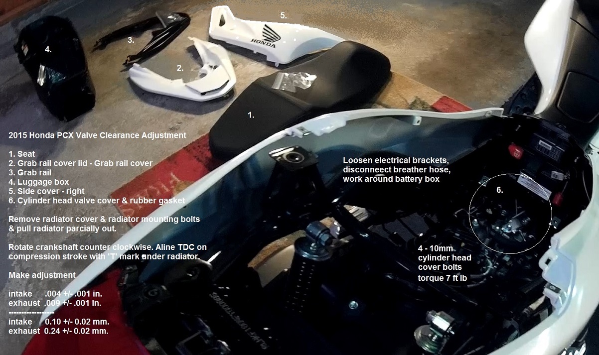

Homie-
Has the below procedure changed since written ? Any updates or gotchas ? How long to execute this procedure ? 2017 compatible ?
Thanks so much
Thanks so much
You can still use the 2015 PCX valve clearance adjustment youtube video from my channel to service 16,17 and now 2018 models... no significant panel or engine changes.Blackroot wrote:Homie-
Has the procedure changed since written ? Any updates or gotchas ? How long to execute this procedure ? 2017 compatible ?
Thanks so much
First time doing the procedure you'll be needing a weekend for sure. Take your time, don't force anything and don't loosen the tappet nuts until you check the clearances because most likely they are within tolerance. Not many have reported needing to make adjustments.
Watch the video in its entirety on a device that allows you to see the annotation. This is where you will read any updates, shortcuts and warnings. Not that difficult and requires patience more than mechanical skill or special tools. There is a tiny tab on either side of the grabrail cover that's almost impossible not to snap off but not critical if you do break one for reassembly. Also the battery box bolts need your attention prior to reinstallation but this tip is in the video.
https://www.youtube.com/playlist?list=P ... oyVAcpcIwl
The first time I did it I watched Homie's video first the evening before - and then on a Saturday did step by step with the laptop closely replaying the video - took me @5 hrs because I was very careful and methodical. I expect the 2nd time will take me 1/2 that time, maybe less.First time doing the procedure you'll be needing a weekend for sure.
There's a lot of talk/fear/etc/etc about this, it's just not the hard thanks to Homie.
