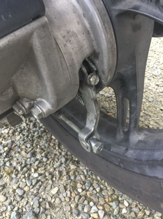

Here's mine after 34,000km (it did have a brake pad change the other day, but I'm in that area quite regularly adjusting the rear brake and I haven't noticed any change).

Probably just normal lubricant from the brake pivot.
Clean it off thoroughly and see if it re-appears.

gn2 wrote:Probably just normal lubricant from the brake pivot.
X2

Clean it with Brake cleaner spray and see if it comes back. Could have been an over zealous mechanic playing with his spray lube can ???
