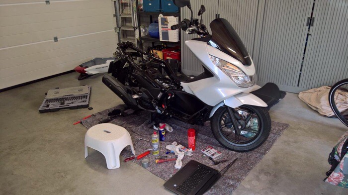

Just finished valve clearance check with the help of Homies youtube video, the inlet valve was spot on, the exhaust a little adjustment, broke 1 clip and a tiny tab but that's o.k
Ready for the next 4000 km ! :D

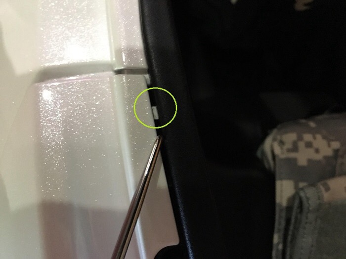

Let me guess 'grab rail cover' there are 2 tiny tabs, one on each side and you don't expect them to be there, did the same thing. Good news is those have no effect on the cover fit up or panel vibrations. I'm wedging it apart in this picture to show it but it will ride tight without it.. you won't miss it at all.
