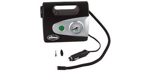

I have this guy . . .
Slime Inflator.jpg (14.44 KiB) Viewed 7506 times

by Gil
That's the one I bought. I just checked the fuse I installed on the aftermarket accessory socket and I have a 20 amp fuse.

"I may return my current Slime Inflator and replace it with the one that comes with multiple types of connectors."
You could keep your present inflator and just buy an adaptor that has alligator clips on one end and a cigarette lighter socket on the other. Then connect directly to the battery. Just note that you could run your battery down to zero with an inflator. I have, so I know. Just make sure your battery is fully charged. By the way, I have an inflator just like the one pictured above.

Here are photos of my Slime tire inflator and the Battery Tender Junior I've used for years. Both work flawlessly still.
But do Note: I've never used the Green Slime Tire Sealant in the kit so I have no idea if it truly seals and if so, for how many miles :roll: But! I've read on other forums that it works. To each his own ;)
