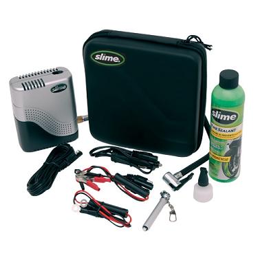

I have this guy . . .Gil wrote:Thanks for sharing, as I bought one of those small slime air pumps. I got the $20 dollar one though. Which one do you have?
I got a flat today and I was outside of town, barely made it to a gas station to patch my tire. I had just bought a tire plug kit, but no inflator kit. Now I have a pump and an air pump, ready.
Which pump do you have?
Gil

That's the one I bought. I just checked the fuse I installed on the aftermarket accessory socket and I have a 20 amp fuse.
I think I tested it with a cigaret lighter and it held up fine, when I installed it that is.
Gil
Gil

Here are photos of my Slime tire inflator and the Battery Tender Junior I've used for years. Both work flawlessly still.
But do Note: I've never used the Green Slime Tire Sealant in the kit so I have no idea if it truly seals and if so, for how many miles
But! I've read on other forums that it works. To each his own
