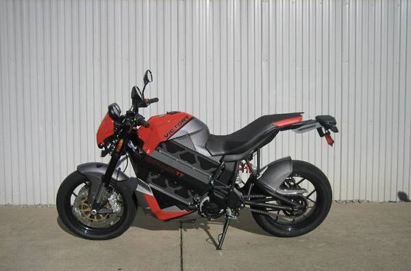

Nope but here's one someone rode for 127 miles and would like his 12k backSmaug wrote:That's true.... for now.
Have you seen Zero Motorcycles yet? They're starting to take a bite out of the dirtbike and supermotor markets. Instant torque and not a need for big range. Higher end models are getting to the point where they will go over 100 miles on a charge. But they're very expensive now, because there's not much competition.
https://chicago.craigslist.org/chc/mcy/ ... 52766.html
