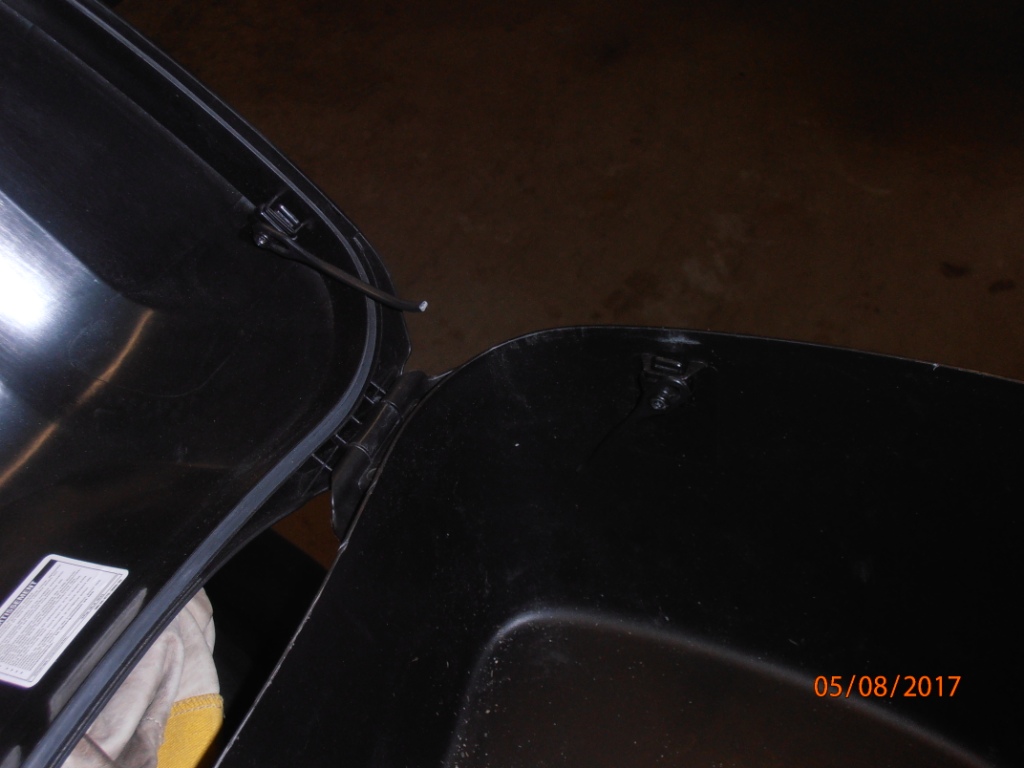

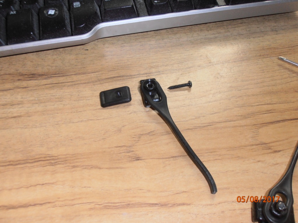

I guess the pictures tell the story....both of the plastic arms that prevents the lid from opening too far, broke at the same time without any abnormal force.
I assuming replacement arms would not be cheap, as it's connected to the plastic "slot-nut" so you can't just replace the arm.....will see how much Honda wants for a new set
So for the short term, I just did a "MacGyver fix" with some 22 gauge wire, will see how that holds up
Has anyone seen this problem before?

Definitely something MacGyver would do.
The only other thing I can think of is to take a couple of heavy duty fishing leaders and modify them so that both ends will hook onto the existing holes. It would be rust resistant and plasti-coated and probably hold up a lot longer that the original arms. Plus you could put them on or remove them as easy as putting on or removing a hook.
My EMGO trunk (older style) didn't have any arms on it.

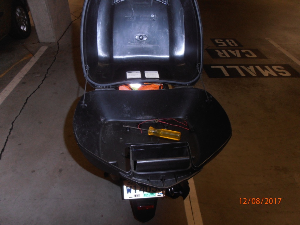

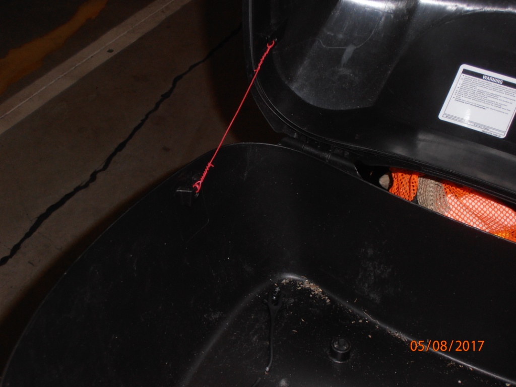

yup...I did both side, the pic shows the original broken arm, just wanted everyone to see the before/afterGeorgeSK wrote:Seems to me that a couple of bits of line would do a better job anyway. One one side, two noose sort of knots that would snug up to the studs and on the other side, make one loop adjustable so that the strains are met at the same time.
You probably do want restraints on both sides, or the hinges will not be loaded the same, and eventually one will fail.
I'm not much of a knot man, but I'm sure I'll be able to MacGyver it a bit better than it is now

I replaced the wire with a shoe lace, looks better but functionally not as good as the wire would bend inwards, where as the string can go any which way and can get caught in the lid when closing.
I think I'll go back to the wire concept, but will use black wire and make it look better

Here is a thought. Use the braided wire used to hang heavy pictures. Then put some black shrink wrap around it, and presto...looks good and functions beautifully.

If you want the lines to come inward, perhaps you could loop another bit of line through a moderate sized nut (3/8"? 4-6 mm?) and tie the line to the center of each support cord.
Or not worry, unless the trapped line is screwing up your box's seal or offending your sense of "right".
