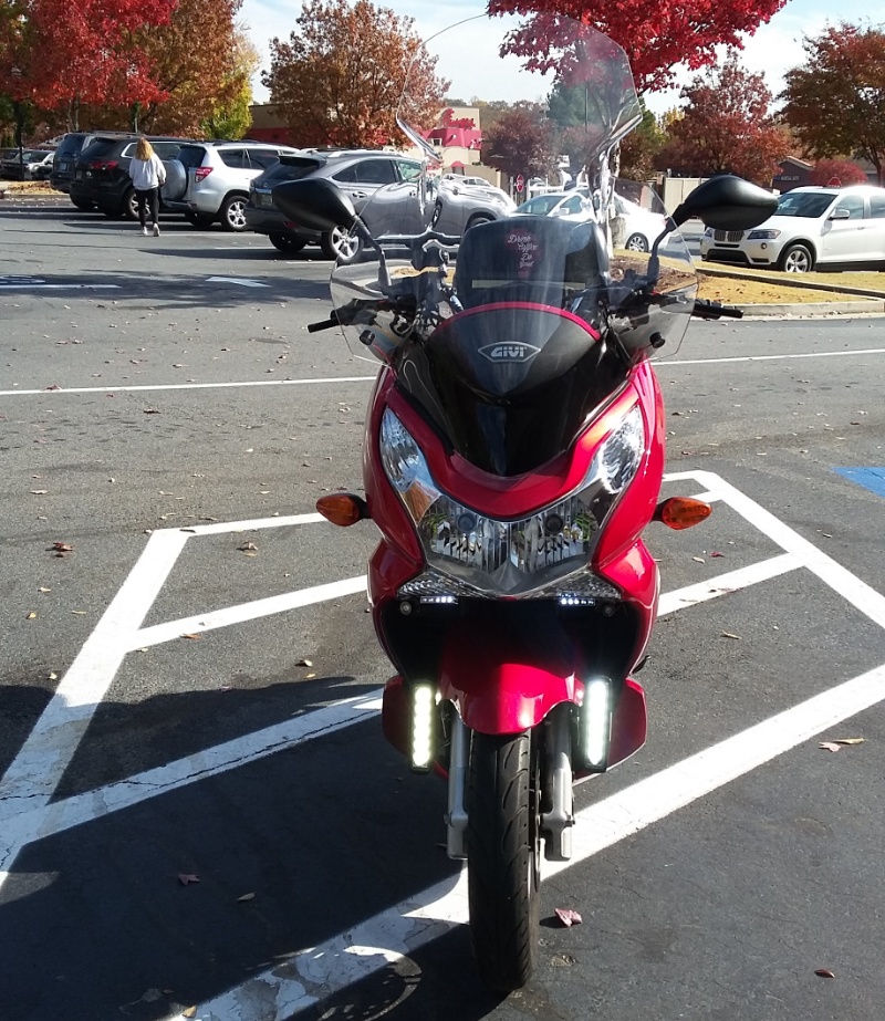

You have a 2013...hmmm. I have two of them. I not only couldn't get the beams to adjust but they looked like they were dim as compared to the newer ones that are out. Several of us, if not more, added extra led lights that work much better than the ones that come on the bike. I have read of others who have changed their factory lights out to the newer LED ones. Here is a picture of not only the new lights on each side of the front wheel, but also some position led lights just below the light encasement (which is missing most of its lights for some reason.) It shows up quite well at night AND we can actually see the road.
Extra lights.jpg (102.03 KiB) Viewed 3359 times

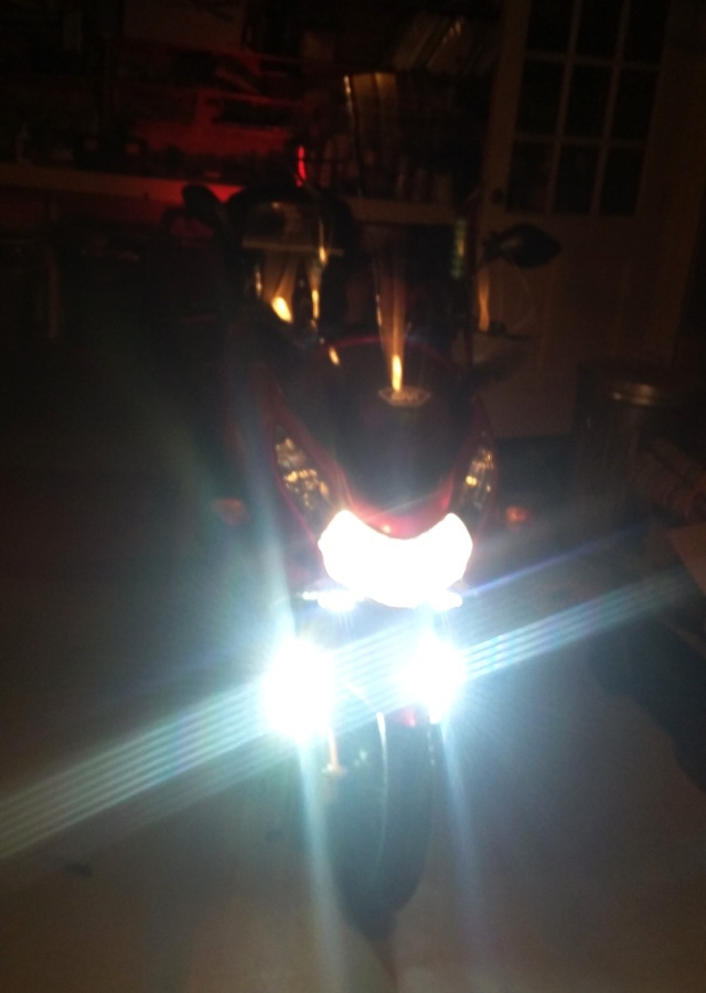

Posted: Wed Jul 26, 2017 4:51 pm
Extra lights in daylight.jpg (342.47 KiB) Viewed 3356 times
Here is what they look like in the daytime. Regular headlights were off for this picture, to show contrast.
