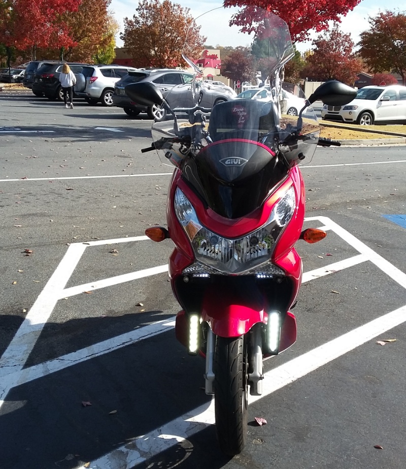

You have a 2013...hmmm. I have two of them. I not only couldn't get the beams to adjust but they looked like they were dim as compared to the newer ones that are out. Several of us, if not more, added extra led lights that work much better than the ones that come on the bike. I have read of others who have changed their factory lights out to the newer LED ones. Here is a picture of not only the new lights on each side of the front wheel, but also some position led lights just below the light encasement (which is missing most of its lights for some reason.) It shows up quite well at night AND we can actually see the road.
Extra lights.jpg (102.03 KiB) Viewed 3317 times

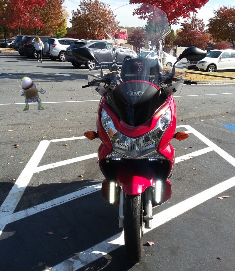

Extra lights in daylight.jpg (342.47 KiB) Viewed 3314 times
Here is what they look like in the daytime. Regular headlights were off for this picture, to show contrast.

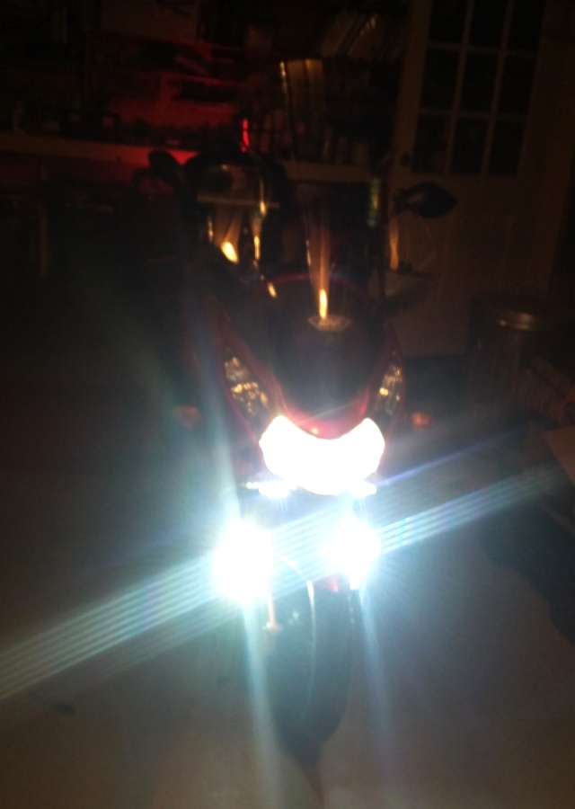

Hey, Mel, I got a question.
I installed some 6-LED lights for night driving, but they are so bright,
I have to turn them off in oncoming traffic. Then, the stock lights are
way too dim to see. Any ideas? Yeah, I have the 2013 model, too.

dgnyberg, I am not sure where you installed you lights, but if they are like where mine are installed they will need to be aimed down a bit further if they are bothering oncoming traffic. You can usually look at them and tell if they are going to aim too high once the beam is a certain distance away from the bike. A good suggestion is to aim them like Homie said. Do it at night and you will be surprised at how bright they are. I modified the way mine are attached so that I can adjust them in increments, plus I have a switch on my handlebar that allows me to turn them off or on. I also have some baby strobe lights on the bike for evening riding, if I don't or can't use the flood/spot lights. After all, they are Kawell, which is advertised for off road use, so you have to be careful where they are aimed.

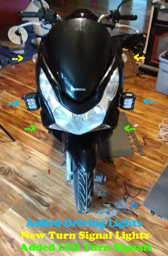

Mel46 wrote:dgnyberg, I am not sure where you installed you lights, but if they are like where mine are installed they will need to be aimed down a bit further if they are bothering oncoming traffic. You can usually look at them and tell if they are going to aim too high once the beam is a certain distance away from the bike. A good suggestion is to aim them like Homie said. Do it at night and you will be surprised at how bright they are. I modified the way mine are attached so that I can adjust them in increments, plus I have a switch on my handlebar that allows me to turn them off or on. I also have some baby strobe lights on the bike for evening riding, if I don't or can't use the flood/spot lights. After all, they are Kawell, which is advertised for off road use, so you have to be careful where they are aimed.
Thanks Mel, my driving lights are where the turn signals used to be. Yeah, mine are off-road lights, too. Which lights did you use for the strobe lights? Are they the ones you mounted under the headlight?
I added new turn signal lights and put LED strips in the lower headlight locations for turn signals, too. Here's a pic.
Front Light Mods-small.jpg (104.45 KiB) Viewed 3166 times
