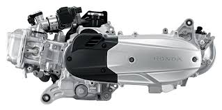

The engine the header is bolted to is on the swing with every bump in the road, not a traditional swing arm on scooters... follow the engine mount bolts and you will see that (bracket) is not a swingarm :D

Engine, wheel and exhausts are all one unit. That's the principal of most normal scooters. Excellent packaging but high unsprung weight.
