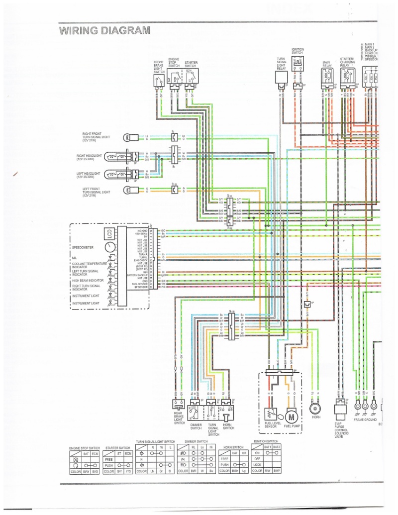

Honda_PCX_2014-more_Electrical_wiring.pdf
(67.41 KiB) Downloaded 734 times
I am sure that you have the SM but here is the wiring diagram to help you along.
This is for the 2014, but I do have the 2013 as well.

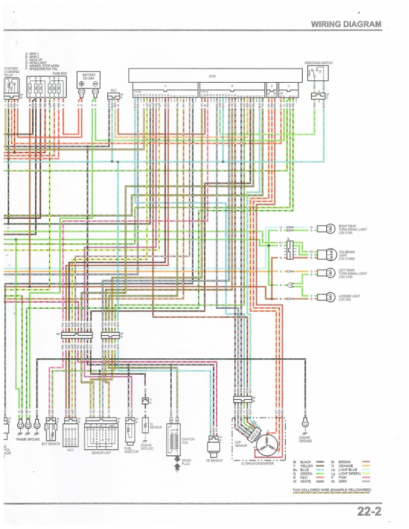

2013 wiring_pg2.jpg (234.59 KiB) Viewed 32142 times
2013 wiring_pg1.jpg (272.9 KiB) Viewed 32142 times
Here is the 2013 wiring diagram, for anyone who may want or need a copy.
